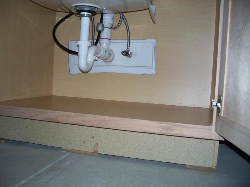

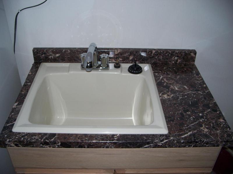

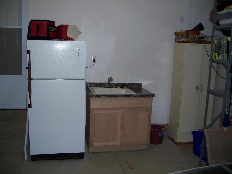

sink base cabinet, countertop and sink finished. Oatey AAV used for venting
