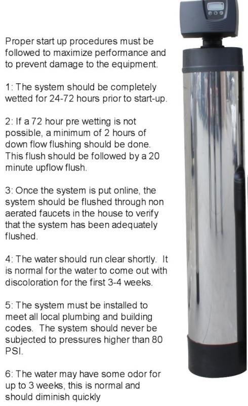

The smell you are referring to is common in the higher grade Carbons. it is likely bituminous coal based. The smell will go away within a week or so. I would recommend pushing the regeneration button on your 7000SXT for 10 seconds, when you see it show a BW and it starts counting down, unplug the system. Let it run to the drain (or the lawn if you dont want to waste the water) for an hour, then plug the unit back in. It will then finish counting down and finish the flush cycle. This will help with the odor issue. Please see the startup sheet we ship with GAC units, this should help.
FYI, my own system had the exact same problem for the first couple of days. The proper startup procedure for carbon is to let is soak in water for 72 hours, then perform an aggressive and long flush in the backwash position. This is not really feasible in many applications so a few extra backwashes can lessen this long start up procedure. 7000startupgac.jpg

Thank you very much for the prompt replies. Last night the installer ran the regen cycle on the tank once, which is a 10 minute backwash followed by a 10 minute "Rapid Rinse" cycle. I ran it a second time last night after he left. After noticing the egg smell, I ran it a third time last night, to no effect.
I just drained all of the water in the house, hot and cold, while bypassing the carbon tank. Confirmed that the smell is coming from the carbon tank. There is a hose bib on the isolated plumbing from the carbon tank (it was for soft water on my old system). With the unit bypassed, I got glass after glass of water from the isolated carbon tank hose bib. Every glass stunk of sulphur/rotten eggs. The muni water is odor free.
Yes, I believe that the carbon is from coal. I do not believe that it was coconut carbon but I will confirm. The installer had black pails of carbon with white 3M labels, but I didn't look any closer at them. I will confirm with him, though.
Assuming it must be the coal-based carbon, I am relieved to hear that it will dissipate in a few weeks. I will let it sit isolated for 72 hours. Since I have a plumbing bypass, it can sit for as long as I want at this point. I will also ask the installer to do the flushing steps dittohead referenced above.

I let it soak over the weekend, using the plumbing bypass so it's not entering my water supply. I triggered a few more 10 minute backwashes (that's what it's set for right now). Still smells like sulfur. Haven't done a long backwash yet and am holding off on doing so until the installer addresses the issue below.
I spoke to the installer. He told me that he used acid washed coconut shell. He said that he used two kinds but that the majority was 3M brand. That's all I was able to find out thus far. He has not heard from the carbon company yet. He did hear from the "manufacturer" (he didn't specify who that might be so I don't know). The latter suggested to him that he needs to change the DLFC. Apparently he didn't account for the fact that it's being used on a 16" tank and the thought is that it isn't getting enough oomph in the backwash to raise the bed.
He's coming today later in the afternoon so I'll know more then.
