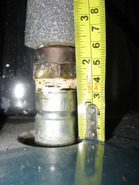

All things do seem to be pointing to the HWT; I do have short nipples on my HWT but they seem too short to be heat traps...http://www.flickr.com/photos/birdi/6601668129/sizes/z/in/photostream/Although I can't feel any clunking, I do hear some slight "metallic" like sounds when the water turns on/off. It sounds like bits of metal or marbles are hitting each other in/near the HWT.
Those could have the floating ball in them. Without pulling the pipe off the end, it's hard to say. You may want to have someone run the water and put your ear close and listen for it.

I'm going to try and change the heat traps as suggested, everything seems to be pointing to the HWT. I'm also going to try and get my hands on a water pressure gauge, it would be nice to know exactly what the water pressure is in my house.

You may not have to change the nipples but, rather, pop the heat traps out of them.
+1
I suspect new ones would make the same noise. Mine have been making that noise from day 1.
It's because now and then tank sediment gets up into them and they get sticky that I'm considering removing them. Laziness has prevented me cuz there are no unions so I would have to cut or unsweat the pipes to get at them.
