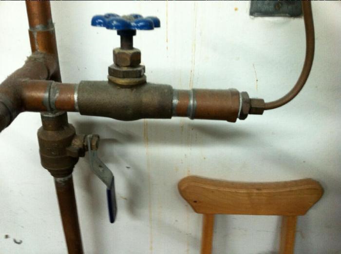

This my ice maker tap off the 3/4" water heater input line. It was installed many years ago. Today I prefer all ball valves. This could easily be replaced with a ball valve one day if had the notion to do so.
Jerry
