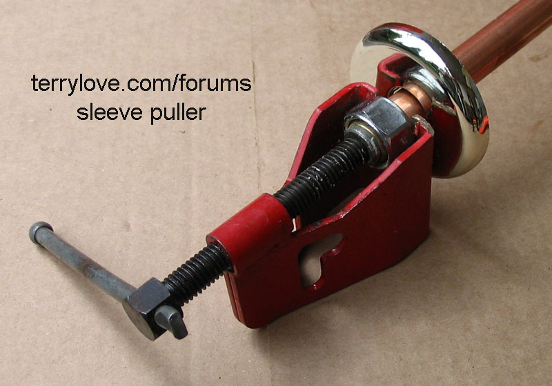

    Today I installed two compression fittings. One is leaking a little. A drop every minute or so. I think I tightened it a little too much. I was going to remove the valve and wrap a little teflon on the compression ring and put thread sealer on.
    Should I instead replace the compression ring? Can these be pulled off easily or should I get a ring puller?

    You should use a puller, although there are techniques to cut it off.
    If the pipe has been "tweeked" to much, you may still have a problem. If you could cut the pipe back, this would be ideal. A little pipe dope is a good idea; most folks recommend against teflon tape, but some guys do use it successfully.

    Jimbo - will a faucet handle puller work or is there one specifically made for compression rings?

    They make a pipe insert that let's you use a faucet handle puller to pull the rings.
    14,207
    We use sleeve puller like these.
    I find that the instructions that come with the compression stops work fine.
    I little bit of oil on the threads. WD40 works fine.
    NEVER Telflon Tape
    YES on lubricant
