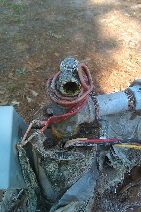

As mentioned in your other thread, that whole mess is due for some upgrade to code, and here I agree with code. Conduit, cover, new valve, etc.
Your well tank might be waterlogged causing a pressure spike, or that sad valve is not set for the correct pressure.
At least fix the wires and get that thing under a dog house.
