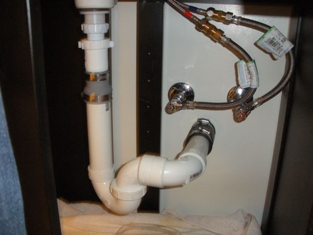

My husband and I just installed a new bathroom vanity from Ikea. The house was built in the 1970s. Water pipes are copper and the drain line is ABS.
We ran into a few challenges because the Ikea faucet connections were 1/2" instead of 3/8" and were also not long enough. We used a 1/2" male-male adapter to join the Ikea connections to a 1/2" to 3/8" supply line. Replacing their supply line all together was not an option because of the strange way it connected into the faucet. We probably won't be buying an Ikea faucet for our next bathroom project.

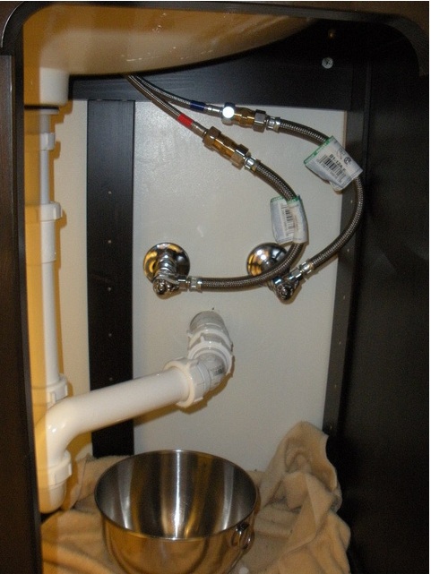

We also moved the vanity over a few inches to the left so it would be more centered in the space and not right up against the wall. This meant that our drain line was off as well. I have attached pictures of the solution my husband came up with.
We are curious to know if this is against code in any way or whether it is a problem to use the "twist" connectors to connect the PVC drain pipe pieces.
Any advice would be much appreciated!

THere is nothing "wrong" with it, but it is not the most secure way of doing it, because those extra slip joints can fall apart if the pipe is bumped.

So we decided to redo the drain line because DH forgot to put teflon tape on the slip joint connectors or somehow did them wrong because they were leaking like crazy.
He bought the stuff so he could do regular cemented PVC pipes. However, he bought a couple of rubber 'banded' type size reducers to use. I have attached a new picture. I am not sure about these rubber things because they seem very flexible and the section of pipe in between them is wobbly.

There is no new picture.
Teflon tape for slip joints... not proper.
Rubber couplings... what for?

Sorry, was having a hard time getting the picture uploaded. It is attached now.

So why are the rubber couplings being used?
If you have abs, why not use abs for the piping under the sink...?
You've got just as many points for failure as you did before...

We were told that PVC was better (I guess not many people use ABS nowadays?). He says he used the couplings so the drain could easily be disconnected. Apparently there isn't much length left on the ABS coming out of the wall.

Mixing materials isn't going to be better...
If the Ikea sink has a weird tail piece on it, I would source out a 1 1/4" drain/tail piece and use a proper trap adapter rather than the rubber reducer and 2 slip joints...

Ok thanks for the feedback. We are going to keep an eye on it and see how it does.
Unfortunately the whole drain assembly that came with the Ikea sink is integrated with the oddly-sized tailpiece so we probably won't try to replace it right away unless we see some issues with it. We understand that it is not the usual set-up.
DH thinks the problem with the slip-joint connectors was that the pipes were not aligning properly. So far the ones coming out of the sink drain have not been leaking.

You have shown how to take a ''simple job" and make a project out of it, and since those rubber couplings, especially the grey one at the sink are NOT "legal" it is not much of an improvement. I would have done it differently with a less material and LESS time, and it would still be removeable. Proper slip joints NEVER need teflon, in fact it does NOTHING to help them seal.
Teflon Tape should only be used on a tapered thread:
Tail piece into the lav drain body
Shower arm
A slip joint nut and washer works best when clean. No goo and no tape.
What you had in the beginning was fine.
