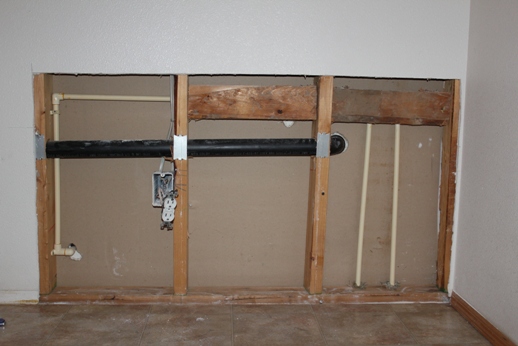

The image below shows the current in-wall plumbing viewed from the laundry room (note that outlet has been moved). Opposite the wall is a bathroom and the drain pipe in question is connected to a sink in the bathroom. The connection from the drain stub in the bathroom to the drain in the wall is a 90 deg elbow. The section of wall on the left not open is where the drain enters a vertical drop with the vent line going up. My question is what would be the appropriate way to connect a new drain line for a sink to be installed in the laundry room. The level of the top of the sink in the bathroom is ~31" and the sink in the laundry room will be at ~37". Thanks in advance for any advice.

To begin with, if that is an 1 1/2" drain, then there is no appropriate way to connect a laundry sink, which requires a 2" drain. If it is 2", then you could
cut in a 2x2x1 1/2 combo right above where the outlet box is to give you a new vent for the bathroom sink, which would rise to at least 37" and then cut
over to the left to connect with the existing vent stack in the next stud bay. Just downstream of that would go a 2x2x2 combo to give you an inlet for the
laundry sink.

The sink only needs a 1 1/2" drain, but THAT drain is going to be too high to connect your sink into it, even if there were a simple way to do it properly, which there is not.

Just for clarification not sure what you mean here that the drain would be too high. Are you talking the elevation of the drain if one were to tap into that horizontal line? The elevation of the sink drain from the floor is at 19". That cutout space is only 24" tall.

In Washington, under the Uniform Plumbing Code, all laundry sinks require 2" drains. Of course, if there is to be no inspection, you can ignore this requirement:
so many folks do. The new vent serves the lavatory, which you say is at 31", so 31" + 6" = 37". The new drain would only be too high if the laundry sink had an
unusually low outlet.

I don't see in this picture how the vent to the left will connect and vent both sinks correctly.

jimbo...vent is in area that hasn't been opened up yet.

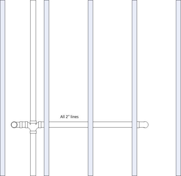

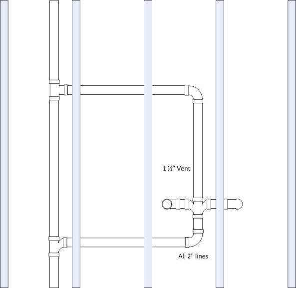

And I thought this was going to be an easy slam dunk. I have a couple of options I am considering and would like your opinion. Ideally I would like to have the sink to the right of the middle stud, but if not the left will work as well. Option 1 below would put the sink on the left. I would need to replace the current fitting on the vent/drain line to a double fixture fitting. This is probably the easiest. Option 2 would require replacing the vent/drain fixture with a 2" san tee, adding a double fixture fitting, running a new 2" drain line to the san tee, and adding a new vent line. I have a few questions about option 2.
1. Since I only have the wall open on one side I would only be able to place nail plates on the open side. I'm guessing this isn't to code so I would need to open up the other side in the appropriate places and add nail plates?
2. Are there any requirements around the double fixture as far as the length of horizontal runs or the vertical distance drop before you can go horizontal?
3. This would require drilling new holes through the studs for the 2" horizontal drain line. This is a non-bearing wall so there is room, but what are the requirments as to how far away/how many holes you can have on a given stud? Assuming just adding another hole would violate code what are the options for adding structural integrity to the stud so it can be done?
Option 1
Option 2

Your plumbing is fine if you add a cleanout below the tee.
IRC Building code allows a 60% hole or a 40% notch in a non-bearing wall. A 2" I.D. pipe in a 2x4 doesn't work.

Using Visio for drawing. I just created those fixtures as shapes. If I end up doing more plumbing I may make up a whole series and pretty them up a little. I was thinking 2" would be 2 1/4" OD but I guess not. More like 2 3/8". So really the only option would be 1 assuming they make a double fixture that has 2" on one and 1.5" on the other? For the cleanout would that be a straight T or something like a long 90 or san tee?
Or I guess I could use a double fixture with a 2" all around and go from 1.5" to 2" on the existing line?

So option 1 is the only option I guess. So is that design ok using a 2" double fixture cross and expanding from the 1.5" existing drain to 2" at the fixture? Also is a cleanout required as the photos from this site I have been basing the design off of do not have cleanouts. If I haven't said it enough thanks everyone for all your help.
