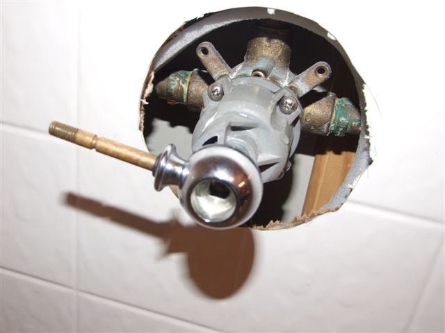

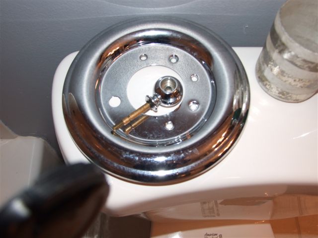

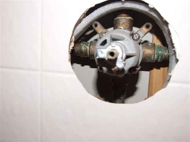

I have a shower mixing valve , single handle, bought at Home Depot or Lowes 7 to 9 years ago. The water temperature has gotten colder and colder over the last month. Water temp in all the other showers and kitchen faucets in the house ( including the sink in this room) is very hot, so I believe either teh mixing valve assembly has gone bad, or gotten clogged. There are no identifying marks that I can find (other than the wod "DOWN" on the exterior of the cassette. I am assuming that to fix this I just need to identify the model and mfr. of teh assembly and replace the cassette... but have no clue as to who made this...Assume it is a Moen, Kohler, or Delta. Pictures attached.
Can anyone identify what this is, or tell me what to look for, ideads ofr troubleshooting? I ghave taken the cassette assembly apart- could not see any visible clogs or calcium buildup, the 2 mesh screens are black, but scraping them doesn;t appear to dislodge anything that woudl clog them. rotating the single hande, operates the mexhanism without friction....
Thanks in advance!

It should be an American Standard "UltraMix" valve, which is pressure balanced, and balancer is probably getting stuck towards the hot side, disrupting its flow.

Thank you! So, is it a matter of trying to clean it out/ how do I get it "unstuck" (it seems to be turning easily when I take it aprat, or should I just try to buy a replacement cartidge?

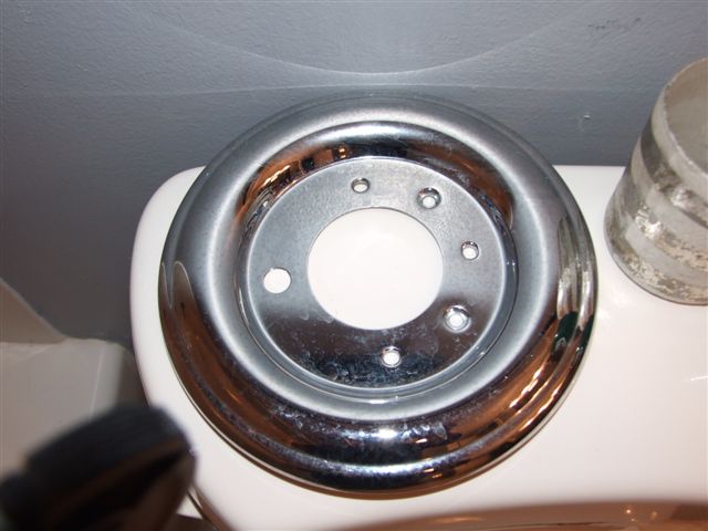

Looks to me like someone has jury-rigged your escutcheon. But yes...just get a new cartridge.
I though this model was older than the 7 or so years you describe, and also never say it at HD. But anyway, it is what it is. A good supply house can get your parts. Not likely to find them at HD. I am sure google will also find them if you are so inclined. try Alfanoplumbingparts.com or nyplumbing parts
