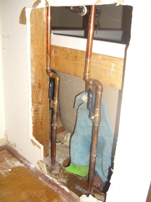

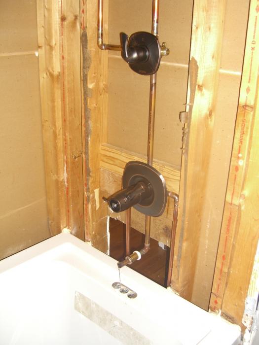

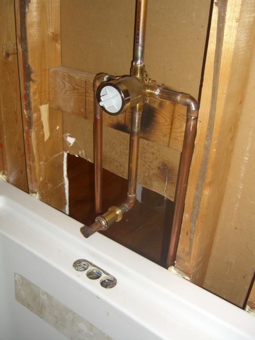

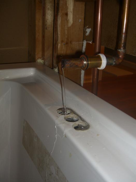

I finally finished sweating the valves and lines together in my bathtub project. Problem now is I'm not getting water! With the valve trim fully open it is only giving me drips out of the tub spout.
I've provided pictures of what I've got.
I installed two shut-off valves and two 90 degree elbows
to relocate the valve trim so that its centered with the new wider tub (3 inches to the left of original valve body location). Is this causing enough restriction to give me only a drip?
The valve body and Delta trim kit were all installed according to their instructions. Please see photos for the setup. I am using a Delta R10000-UN valve body with the Addison trim.
Another alternative would be the actual water supply, but the spout for the toilet and faucets in the same room are working just fine.
Some searching has pointed out that sediments could be clogged in the lines.
But, I'm not sure if that is the case.
Any ideas would be helpful. Thanks in advance!

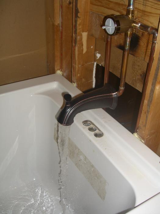

Water!
I removed the Delta handle kit and reinstalled the test cap. I ran the water and it looks like
I am getting full water pressure without the cartridge installed. Does this mean that it is
definetly a faulty cartidge?
Attached is a photo of the water running with the test cap instead of the cartidge/lever.
Thanks guys!

So I tried to check for the PB problem. When the lever is 100% to on...with both HOT and COLD valves open there the spout drips. With the HOT valve open and COLD valve closed drip continues. With COLD valve open and HOT valve closed the drip stops. Does this mean its a PB problem? If so, how can I correct it?
JohnfrWhipple
BATHROOM DESIGN & BUILD
3,225
102
North Vancouver, BC
Was the system flushed before operation - Cartridge removed...
Most fixtures we work with advice this but often this step is not done.
Perhaps you have a bit of "Junk" "Debris" "Solder" or such bouncing around in that cartridge.
33,608
1,047
It probably means you have an obstructed cold line. If it were a PB problem you would have FULL flow from one side or the other, it would NOT shut off both sides. The only time that happens if when one side has ZERO pressure so it lowers the other one, in this case apparently the hot, to match it, which results in little or no flow.
