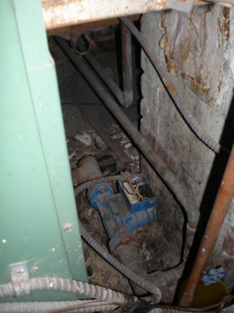

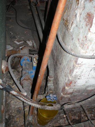

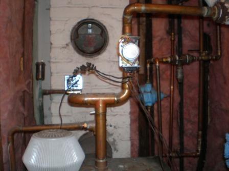

Here are a few pictures of the valves and circ pump
