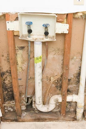

    I am replacing leaking washing machine valves and the outlet box but have run into problems. How do you prevent the new outlet box from melting when sweating on the new copper valve adapters? I have gone through two boxes so far.
    The old valves were sweated directly to the copper pipes. When I removed them, I bought the copper adapters to accept the new threaded valves.

    You remove the threaded valves from the box,
    sweat in short pieces short enough to get back down into the box to nut up and tighten,
    but long enough make the necessary soldering to connect far enough away where the heat of the soldering doesn't transfer heat to the box.
    Usually those lengths are 6-8" depending on where the holes located in the box. If it is a 2 by 6 framed wall, you can run even longer lengths and make this possible.
    Somewhere on my site I have a picture to this idea.....lemme see if I can find it.

    Well, I guess if I didn't have this phobia about screwing things up, I might have come up with that idea. From looking at your pix, I didn't know the valves tightened (attached) to the box.
    This is the old setup I'm working on. Leaks and mold were the main reason for removing the wallboard.
    Thank you and thanks for the pix. A big help.

    If you have the right valves, (and I have never seen those valves used for a washer box), then the solder connections are not close enough to the box to cause a problem.
    Thank you for responding.
    I believe the house was built in '82. But what's wrong with the valves? Don't you use standard water valves?
    When soldering the connections, I used as small a flame as I could, but when the copper pipe and flux got real hot, the flame wrapped around the pipe and melted the part of the box behind it as well as the hole the pipe comes through.

    If your concerned with melting the box why not solder a 1/2 sweat by 1/2 female on some copper pipe and then thread it onto valve body assembly.

    This would work well but you would probably have to enlarge the holes on the box to accomodate the hex female end of the fitting.
    How about this remove the valves from the box and sweat the valves to a short length of copper pipe that extends outside the box. Insert the valves into the box. Then cut the existing tubing running to the valves to fit this stub pipe. Then simply solder the short stub pipe coming out of the valves to the existing tubing with a 1/2" to 1/2" sweat coupling.
    This will keep your torch away from the plastic box and avoid melting.

    No, I use regular washer box valves with the extended shanks and the handles on top. Even ball valves can get tight and the handles being behind the valves could make it very difficult to operate them.
    I've soldered many hundreds of washer boxes and have to say that I've never melted one. I'm guessing you have a torch that I would simply throw away.
    As to that mold - if it were my house, I'd remove the rock on the other side of the wall and replace it. There are rules about such things.

    The torch is one of the usual ones found in hardware stores. I kept the flame as small as possible, but not being a plumber (or even an experienced solderer) is most likely the problem.

    A hotter torch means you're on the fitting for a shorter time...then the cooling can begin. A weak flame means you're on it a long time giving the heat a chance to migrate.
