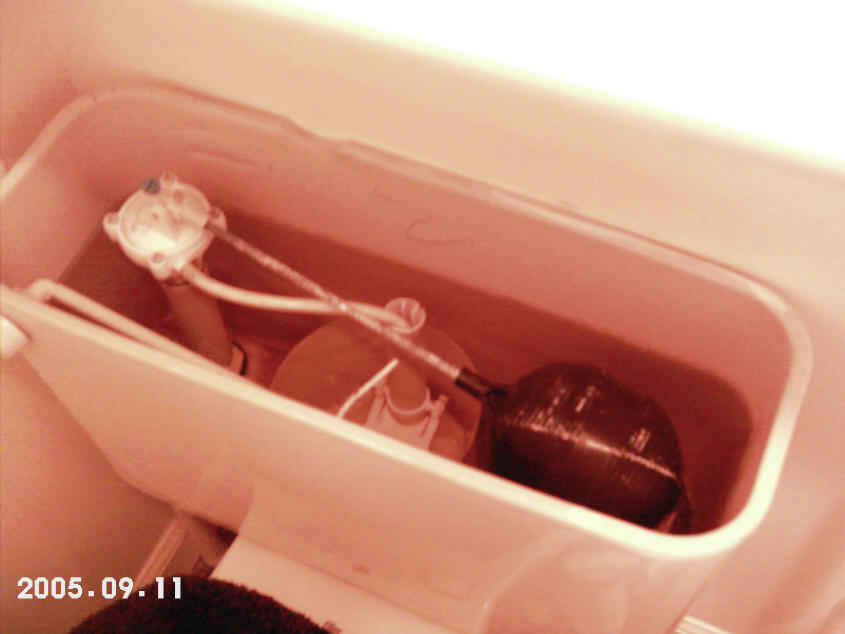

Hi,
Every time my toilet is flushed, it makes a loud sound as the water finishes rising. It sounds like a tuba or a large steamship and it lasts a good 5 - 7 seconds. It appears that the large round flotation device and the arm it's attached to may be the problem as they vibrate when the noise begins and stop the minute I hold the ball and arm still. Please forgive my lack of knowledge of plumbing terms, but I hope this is clear.
Any advice will be greatly appreciated.
RioHyde
339
Cincinnati, Ohio
What you have there is a bad ballcock. Replace it or have it replaced with a fluidmaster 400A fill valve and your problem will be solved.
I have uploaded a photo of my toilet tank. I am assuming the ballcock is the round-ish ball *only*, on the right. What about the "arm" it's attached to? It's attached to a base on the left that's anchored with 4 screws. Does this whole assembly need to be replaced or just the ball? I'm a "do-it-yourself" type, so it looks easy enough regardless. Thanks again.
Gary Swart
8,101
84
Yakima, WA
The whole innards will be replaced with the Fluidmaster. Instead of an with a float ball, it uses a float that rises vertically with the water. Simple and easy to adjust the water depth. The old ball floats are museum pieces now. This is a very easy DIY job.
1,191
If you shutoff works, this is probably less than a 30-minute repair (maybe 10-15 if you do it every day). Turn the water off, flush the toilet - hold the lever down to get as much water out as you can. Use a sponge to get the rest out of the tank. Disconnect the pipe or hose supply (it is a good idea to replace this as well), unscrew the nut on the bottom of the tower the water comes out of. Take the whole assembly out and throw it away. Seat the new one (note, you may have to adjust it for height and water level - see the instructions), tighten in down, install the new supply hose, turn it back on. Check for leaks and level. Adjust/tighten as required. You're done. A Fluidmaster is less than $10...lasts a long time. The only part that fails is a rubber seal, takes about 1-minute to replace and readily available. You might need one in say 10-years or so.
