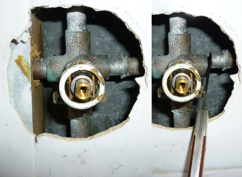

Here is a shower valve located on an inside wall.
See how the ice forced the copper pipe out of the valve body.
We had to reheat this and solder it back up.

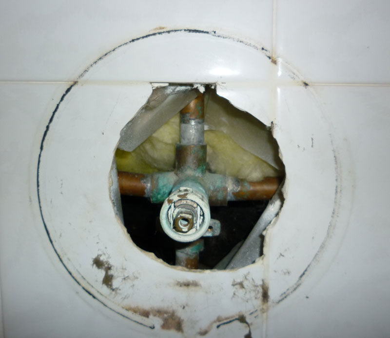

Here is one where the shower riser pulled out.

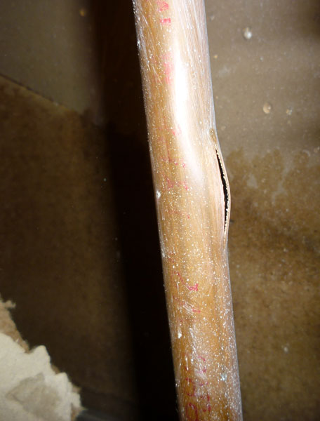

This is what a burst looks like in copper pipe.

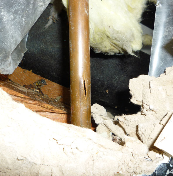

And another burst copper pipe.
