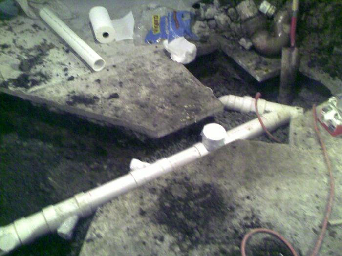

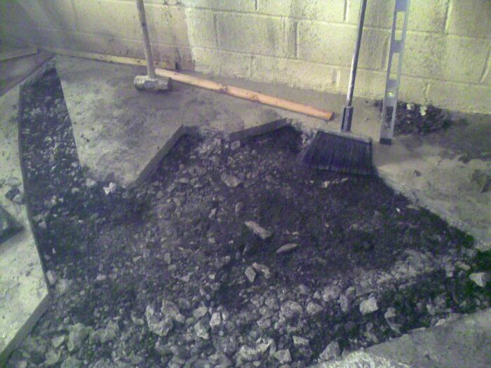

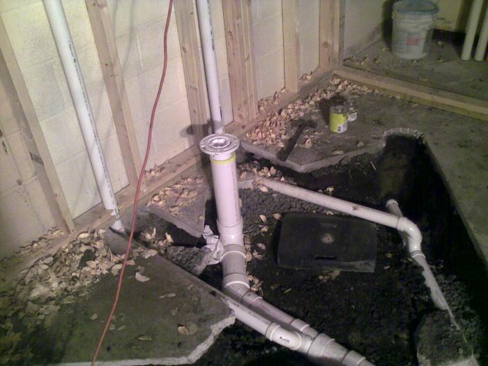

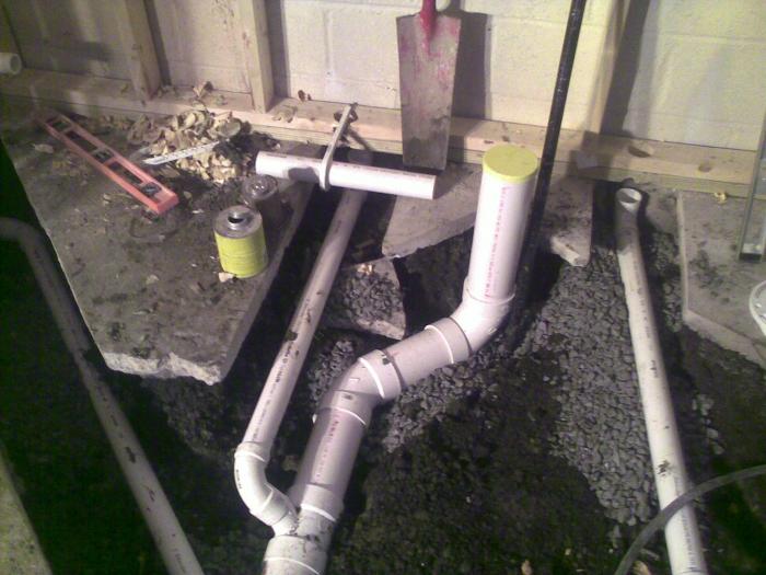

Hi,
I'm finishing up the rough plumbing for a basement bathroom. Looking at the hole I've created, I'm getting nervous about how/if I can patch this. I want to tile over top of this, so I want to make sure things are absolutely solid. A couple of suggestions from reading forum posts, google, and talking to a plumber friend:
1. Fill hole with crushed rock. Then 1/2" drill horizontal through existing slab, and epoxy rebar, concrete over.
2. Fill hole with crushed rock. 1/2" rebar pounded vertically into the ground, in a 6" grid pattern. Concrete over.
I've attached some pictures of what I'm dealing with. Inspector has already taken a look at the DWV, and is happy with it. He wants 4" of concrete over top.
-Kevin

"1. Fill hole with crushed rock. Then 1/2" drill horizontal through existing slab, and epoxy rebar, concrete over."
That is what I would do.
BTW, that whole plumbing rough in would fail here in Florida.
The wyes would be rolled above the flow level.
Inspectors don't like tees below grade on their backs.
My inspectors would fail what you have.
Any fitting below the flood level needs to be treated as a waste fitting, not a vent fitting.

I'm struggling a bit here...but I found this picture from the B&D book that I have been using:
http://books.google.com/books?id=8o...hMnfAw&sa=X&oi=book_result&ct=result&resnum=9
If I'm understand everyone's comments...the below grade fittings need to be a waste-T, not a vent-T, right? I did use waste-T's, and the only difference I can spot is that I didn't use the long-radius waste-T's to transition the vent to vertical. Maybe the picture appears that I used the vent-T, but that is not the case.
Any pics you can show would be appreciated...I'm just trying to fully understand the comments.

I see you are from Ohio, and that is how its done there from what I remember, besides you said an inspector is happy with it.

C NUMB,
I was just reading this post that if it's a dry vent system, you can use a sanitary T on it's back. If its a wet-vent, there's no way you can do that because of the sharp bends. The vent system is dry...there will be a connection to my existing house stack 42" + 6" + couple more for extra insurance above the floor, and so this new basement bathroom will have it's own dry vent system.
