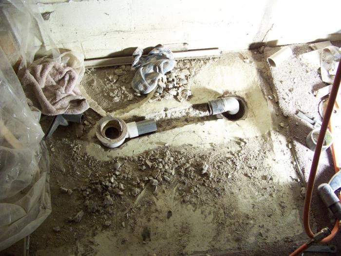

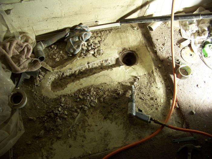

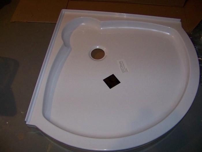

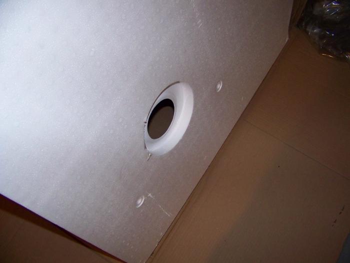

    Ok, here is my dilemma, I tore out an old 32" shower that was sitting on a raised up tray under the shower base. As you can see in the pictures, there was some piping rigged up on top of the concrete floor (basement bathroom). I started cutting and chiseling a trench into the concrete so I can gain some depth with new drain piping as the new shower base only gives me 3/4" from the drain hole to the floor. As you can also see the cast iron pipe and trap was concreted in the floor (many years ago before I bought this place).
    Ok plumbers, what would you do to get this thing plumbed up. I live in Western PA so "up-to-code" isn't the priority here. Just getting it to work.

    I'm not an expert, but what you have there, doesn't look like it would meet code. I can't tell about the trap, it doesn't look like a standard one legal in the US, if it's a trap at all. Then, there's no vent, which also doesn't meet codes. Need a little more info to be able to see what's there, and the way to fix it.

    Although trap was thrown out earlier in the post have we determined that there is a trap below the original drain location┐ I know "we" could give a hootin' nanny holler if there is a trap but just work with me, buddy.

    To do that, it needs a trap, AND it needs to be vented for your family's health. Can't tell from your pictures what you have, but it doesn't look like you have either a trap or a vent.

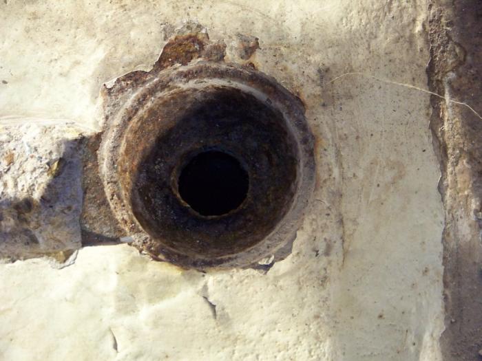

    replacing the galvinized elbow, the black pvc, all of that isn't an issue, I can go to my local hardware and get the right materials, what my question now is, if I jackhammer up the concrete, what do I do with the cast iron pipe? It seems like alot of unnecessary work. How about finding a "grandfather clause" for me so I can just make this thing work, Yes I will use the right pipe materials, yes I will make it so it doesn't leak and yes I will make sure it slopes down enough so it actually drains. How about I just use some common sense in doing the job and not worry about all the "plumbing code" legal semantics?
    How about checking out my pics of all this mess and seeing what I am actually up against and not just judging it by the fittings in the first pictures?

    When you do a complete tearout, grandfather goes away...the new replacement needs to be up to snuff. Connecting to CI is often not too terrible...the hardest part is cutting the old out. A snap cutter usually works well, but you need enough opened so you can wrap the (heavy) chain around the pipe where you want to make the break (cut). Those are generally available at a tool rental store. Trying to cut it with a grinder or a saw can be done, but is tough - and, you may need more room than the snap cutter requires to have access.

    Man I so wanted to reply to his post on the forum I been banned from. Dude. If you do not care about the code, then why ask the "Pro's" how to plumb it in? You can not run the drain the way you want to. Just break open the floor move the whole P-trap to where it will be directly below your shower drain.

    Ok, how do i move the cast iron piping, it runs underneath the foundation into a clean out. What special tools do I need to buy to do all this work?

    Sledge hammer, saw to cut pipe, no-shear fernco, pipe, trap, shower drain fitting, gravel, cement
