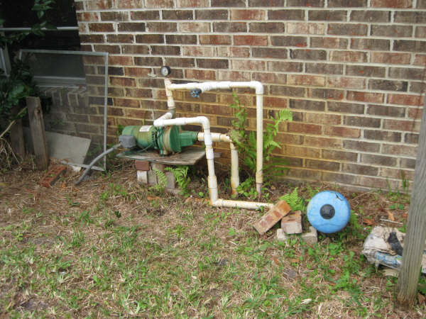

    I bought a house that has a Well Pump. It is in FL. It connects to 2 spigots, but more important it runs the water for a Water Cooled Heat Pump. I am very handy, but know nothing about well systems. I have a few questions. First to get the pump to run I had to prime the pump and then the next day I had to prime the pump again. I would imagine there is a foot valve at the bottom of the suction line to keep water in the system, but maybe it is leaking. On the suction side there is a 1.25" PVC pipe going directly into the ground, therefore I am thinking it is a sand point driven well. I was going to cut the suction line a few inches above where it goes into the ground and see if the water in the line remains there overnight. If not I was thinking I would replace the foot valve. My first question is how would one replace the Check Valve. I would think it would be difficult to pull PVC piping without damaging it. Would it be better to install a self priming pump? And how well do they really work? Do you still need a check valve for a self priming pump?. Also If I did pull the old PVC pipe do you have a design for making a driver to drive a new pipe. I can not imagine how they could have driven the PVC pipe without breaking it. Also I read that the cut-in pressure should be set 2 psi less than the tank pressure and the cut-out 20 psi or so above the cut-in. But I do not see any pressure requlator that would turn on and off the pump. Is the cut in and cut out built into the pump?? The home was bank owned, so no previous owner around to ask about the system.

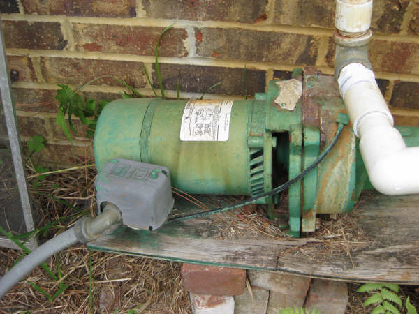

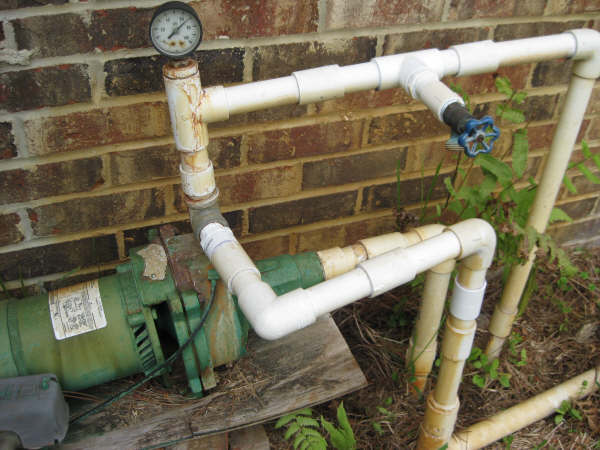

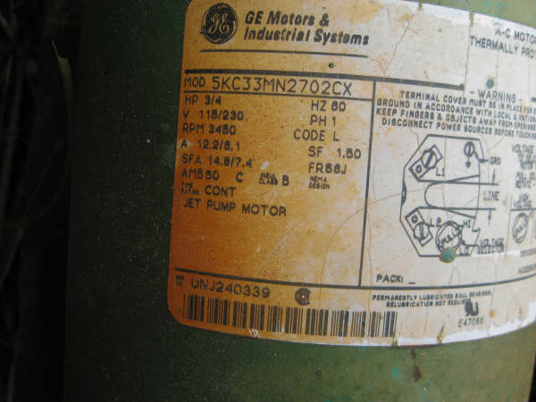

    DIY Member rwbil's Avatar
    Mar 2009
    Florida
    43
    Question
    Speedbump,
    I have attached more pictures. It is a GE Jet Pump. Looking at the photos can you tell better whether or not there would be a foot valve. And if there is no footvalve how would the pump stayed primed?? The discharge line in 1.25", but I forgot to check the suction line. There is a tank on the discharge. Also where would be pressure switches. Any infomation, such as is is defineately a sand driven well and etc., you can provide based on the photos would be appreciated. Let me know if you need me to take more pictures.

    Previous member
    Jul 2005
    Riverview, Fl.
    4,540
    There is no way to tell what is below ground. It could be an 1-1/4" well straight down. It could be a suction line going to a larger well either straight down or somewhere else in the yard. Hell, it could be in your neighbors yard for all I know. The only way you will know is to either dig it up or cut the pipe and try to stick something straight down it.
    That is a Myers shallow well jet pump. Not a centrifugal. The pressure switch is the gadget that the electrical conduit is attached to on the back of the motor.
