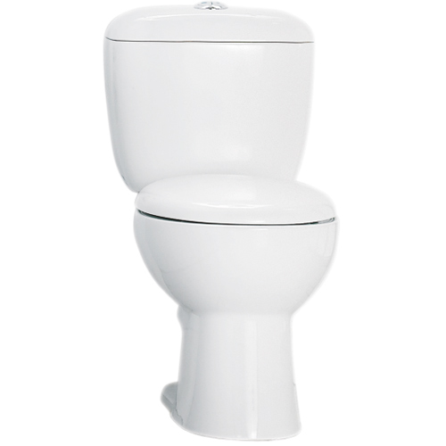

Rona Collection dual-flush
Installed this one last year.
http://www.rona.ca/shop/~toilet-dua...llection-178222_plumbing_eco-responsible_shop
Great price, nice sleek styling. Everything except wax seal included, I did it myself in an hour or so (no experience necessary!).
It's a bit higher than our old 13l toilet - why aren't ALL toilets this high? It's just so much more comfortable!! - with an insulated tank (no condensation anymore) and flushes very, very well on both settings. Easy to keep clean. Huge improvement over the old American Standard. Would recommend to anyone.

DO NOT get Rona dual flush!
Do you import these or something? Unless you are making a profit I do not know why you would post that? It does not flush anything! They should call it a urinal. The only way I can get it to flush is dumping a bucket of about 15 litres of water, plus another flush to leave clean water. how efficient is that?
I thought another forum poster was joking, or maybe it was a big guy, but I'm small... even my wife plugs this thing.
Now I have to go through the trouble of un bolting it, taking it down a flight of stairs and driving it back to get a refund. what a pain.
Also, if you are having children, go with a lower toilet. The taller ones make sense in a master bedroom, but children will have a hard time with the high toilets.
