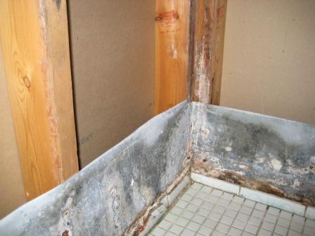

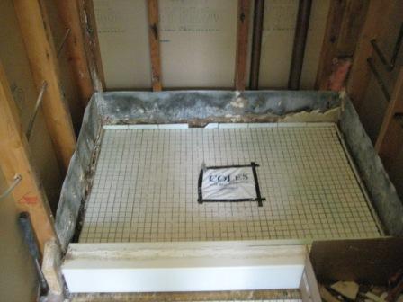

Project started as a simple re-tiling of a 1970s shower-toilet-vanity. Replace the floor tiles (and install in-floor heating at the same time), replace the wall tile around the shower and toilet area, and replace the floor tile in shower.
I found the bottom row of wall tiles around the shower just fell off into my hands. The gyproc behind was wet, so I ripped off all the gyproc around the shower to see if there was any damage to the framing (None, thankfully).
The shower pan is galvanized, 48"x34". I dug out the wet gyproc around the mud+tile slab, which left a 3/4" trough all the way round the inside of the floor pan. There was some free water in the bottom (I wonder why that would not have drained away?)
The shower never leaked. It's on the 2nd floor with no access from below without major damage to 1st floor ceiling. I want to use the Kerdi membrane on the shower walls.
Q1: Is it wise to keep the galvanized floor pan? If not, I have to rip out the entire floor and start again?
Q2: If I can keep it and chip off the existing shower floor tiles, I would want to run the Kerdi membrane down the walls and across the floor pan before installing the new shower floor tiles: Is it possible to tie the Kerdi membrane to the existing shower drain? Or do I have to excavate the old drain and replace it with the Shluter drain? Is that even possible?

Regarless of what the pan looks like above the shower, I have NEVER seen an older one which was not almost completely rusted through under the tile. And if it is not already so, it will probably be worn out shortly. I would take it out and start over.
1,191
That pan is almost certainly flat on the floor. By code, the waterproof layer (the pan, not the tile) must be sloped to the drain. There will be water that gets below the tile and the pan must slope to the drain to allow it to flow out. While it doesn't leak (yet), your pan is not built properly and should be removed and replaced.
Kerdi is only designed as a system...walls, pan, drain. It would not be warranteed unless you use the whole system (note, you do not need to use their preformed pan as part of the system, but can if it fits your needs). There isn't a good way to attach Kerdi to a conventional drain.
Tear it out!
Read up on proper shower construction at www.johnbridge.com.
