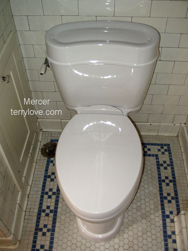

    My wife and I just looked at Toto toilets at a local showroom and like the style of the Toto Promenade. However after reading some reviews, I see that there are better choices. When I spoke with the salesman he told me that the Toto Promenade would be coming out with new interal parts. Does any one have any more info on this - When? Which flushing system? Any info would be appreciated.
    If not the Toto Promenade, which one would be a good choice? Both style and function are equally important. As for style we are looking for something that would fit in an american bungalow (circa 1930's). The walls have 3x6 subway tile and the floor has small hex tiles.

    TOTO Mercer
    The new Promenade comes with with G-Max.
    CST423
    CST424
    Performance similar to the Drake,
    The Toto Mercer pictured above, has the G-Max flush, set in an old home in Seattle.
    Check out the Toto Dartmouth - it's a G-Max flush and has a classic look with a ridge around the tank top and a porcelain handle like the Mercer. We have several and love them.

    Yes these are handsome toilets, and since they both have the G-Max flushing system, I assume that they will function superbly. I did get a little more info from the local salesman. He said that in the 3rd quarter of this year (July 2008?) the Promenade will get a new flushing system, but I still don't know which one. Of course me and the Mrs can't wait that long. The Mercer does look very "period", and the tile work in that photo is very similar to mine. And the Dartmouth looks like it would match the existing bathroom as well. Thanks for your help.
