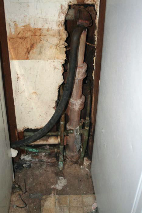

dimprov
Austin, Texas
I took a closer look, and it's actually a NAIL that's partially supporting the drain. The nail is supporting one side, and the wooden block the other.
Is this common? It apparently works, but it doesn't look very comfortable for the pipe.
Anyway, I'd still like to know what the best way of supporting piping is from a sound-proofing point of view. Any input on that would be appreciated.
e.g. is there an isotrax, as it were, for piping? And if there were, would it make a difference in reducing plumbing noise? Please let me know if I'm running down a blind alley.

When you drain hot water through a pvc pipe (say from a shower, sink, tub, etc.), the heat causes the pipe to expand quite a bit. Anything touching the pipe can cause a noise as the pipe expands across it. Then, as it cools, it contracts, so you get it twice. Supporting it, routing it, and designing a good installation can minimize sounds. This type of expansion/contraction can be squeaks, pipes, clicks, etc. as the pipe moves, depending on whether it is held tight and 'jumps' once it overcomes the friction. A well designed installation means it can expand and contract without rubbing on something that will make noise.
