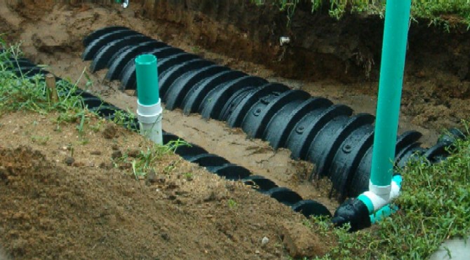

    If your tank's discharge is making it out to the end of the pipe, then that pipe must not be too terribly plugged or filled with roots or whatever. All considered, I would go out and dig a hole at the end of that pipe and install a chamber system. How large that should be would depend upon a variety of things, but the cost for even a relatively large area would not be prohibitive.
