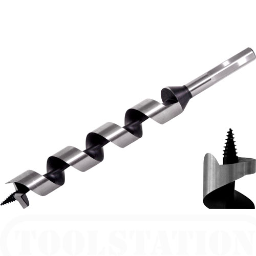

What's the best type of drill bit for drilling through 2x material to pull electrical wire? Forstener? Spade? Auger? Twist? I've got lots of holes to drill and I'm tired of fooling with the spade bits which on a right angle drill always seem to bind. :(
Thanks,
Jason
None of the above...I can't remember the name, but try one with the screw point lead-in. Sort of like a twist drill with a wood screw on the front, it also has some of the features of a Forstner bit. It is designed to cut fast and is self-feeding because of the screw. Interesting to see what others have to say...

Just about every sparky i know, uses auger bits - I'm pretty sure that's what you're describing, Jadnashua?
Yep, that's it. Just don't hit a nail or screw with one. WHen they're sharp, they slice through really fast. Hit a nail, and it doesn't work well trying to tear the fibers at all.

Some brands of self-feeding augers sold by electrical supply houses have nail-cutting capability. I'm not an electrician, but I've done a lot of rework. When you're drilling through a plate you can't always tell whether there is a nail in the way.
Rick
480sparky
149
They're also called ship-auger bits.
And you can get some that will go through nails with no problems.
