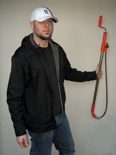

    Have you tried using a toilet auger?
    Closet Auger with 1-3/8" end on it.
