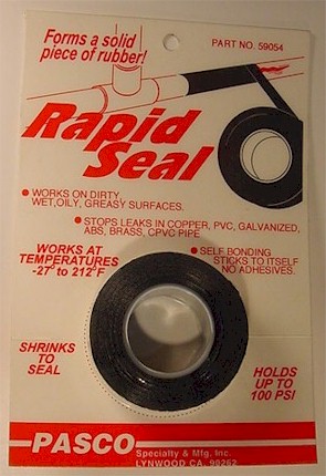

If the spot-welding doesn't work, you can always try this stuff: They sell a version of it at Walmart.

Master Plumber Mark
5,540
358
83
www.weilhammerplumbing.com
that looks like electrical tape....
what will wall mart think of next.....
I have cut MILES and MILES of home made
electrical tape repairs off of water lines and
drain lines......
now someone thought up the great idea of acutally
packageing the electircal tape and selling it for 5 times
the price....
its not the product that counts , its how you package it...
