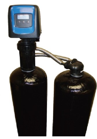

Also, I was reading a thread here where Ditttohead had this reccomendation:
"Here is my recommendation, this is a very unique system designed specifically for your application.
Stage 1: Minimum, A 9x48 Iron and hydrogen removal system utilizing Pyrolox. Please note that your pump needs to be able to pump 11 GPM to properly backwash the Pyrolox.
Stage 2, an parallel tank system with softening resin in tank 1, and Tannin selective resin in tank 2. This unique design eliminates the need for seperate regeneration cycles for the softener and tannin systems. The softener regenerant wast (chloride) is used to regenerate the tannin resin.
This design requires the addition of a resup feeder to lower the pH of the brine water so as to prevent the precipitation of the caco3 in the anion resin bed."
This sounds like it might work for me. I just wonder how exactly the regeneration would work. mainly achieving the backflow rates listed above, and I am guessing that the brine rinse exit on the softener would be the entrance on the tannin filter, then down the drain? So how would I choose a pounds per cubic foot salt setting for the brine? Am I over thinking all this?
Any advice would be greatly appreciated!
