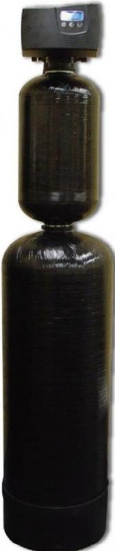

If your chlorine is over .5 ppm, I would recommend removing it. A carbon tank in front of the softener would be the best choice. Even a stacked tank design would be fine. stack.jpg
1 ppm is the upper limit for 8% resin. Life expectancy is hard to estimate, but regardless, do you want to breath in the chlorine into your lungs in the shower, bathe in it, etc.
A pool should be maintained at 1-3 ppm, do you really want to drink and bathe in pool water daily?

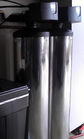

Technically speaking, a large tank should be installed, but... chlorine removal is easy for GAC. Removal of other contaiminants may require considerable contact time. if you look at the specifications of GAC, it has a flow rate of 3 GPM per Cu. ft.. It is really up to you. The right way would be to match the units. That can get very expensive. The stacked tank designs save some floor space, cost, but they give you much less GAC. It will effectively remove chlorine, much better than a BB cartridge and will cause very little if any flow restriction. Here is an old picture of an install I did over 10 years ago. I recently wnet there and replaced the boards with SXT's (used to be SE). This is a dual 2.5 Cu. Ft. system (with pretty stainless jackets!)gacsoftener.jpg The GAC tank goes first, then the softener.
