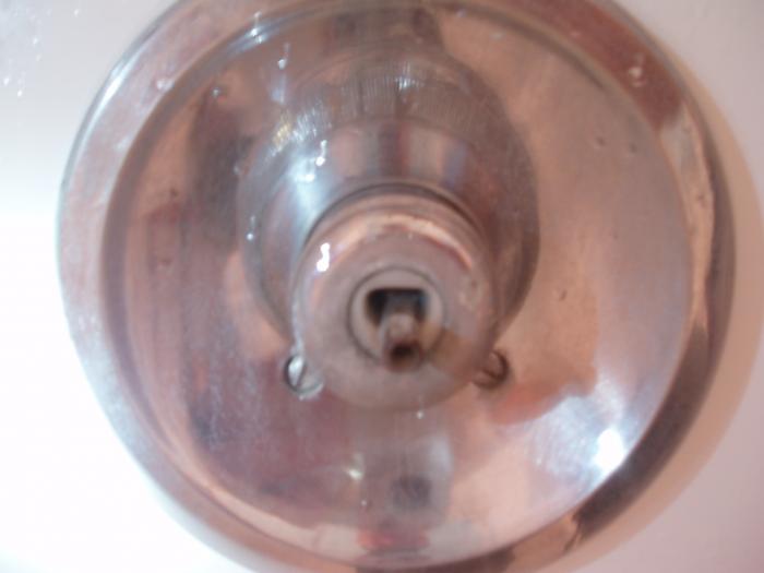

treaged
The valve in the house I am renting is similar to the original OP, except no identifiable marks. It has an acrylic knob handle that I removed and took the picture below: P1010030.jpg
Can anyone tell me what company manufactures it or is it one of those off-brands that no longer exist?
