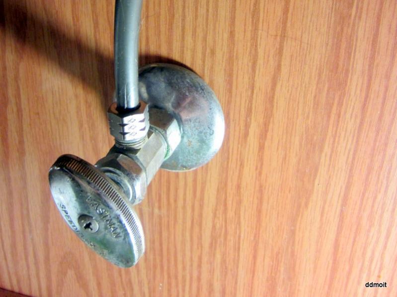

Hi folks. I just moved to Tennessee from Michigan. I'm installing an under sink water filter. It's a unit that uses 3/8" PEX on both ends. The connection piece that they gave me to connect to my cold supply is useless for my circumstance. What's the best way to connect PEX to a standard cold water shutoff valve without using special tools? Can I use an old fashioned nylon compression fitting like the ones commonly used for ice maker connections?

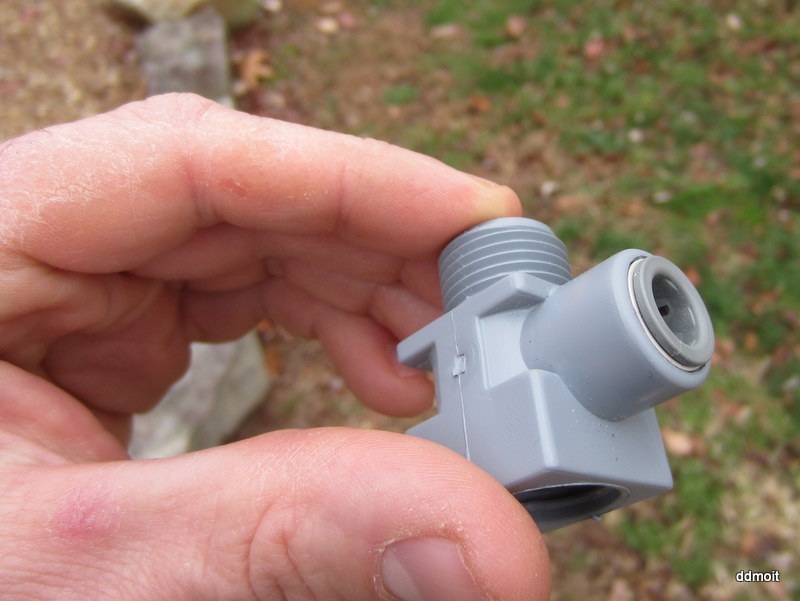

IMG_8123.JPG This is what was provided.

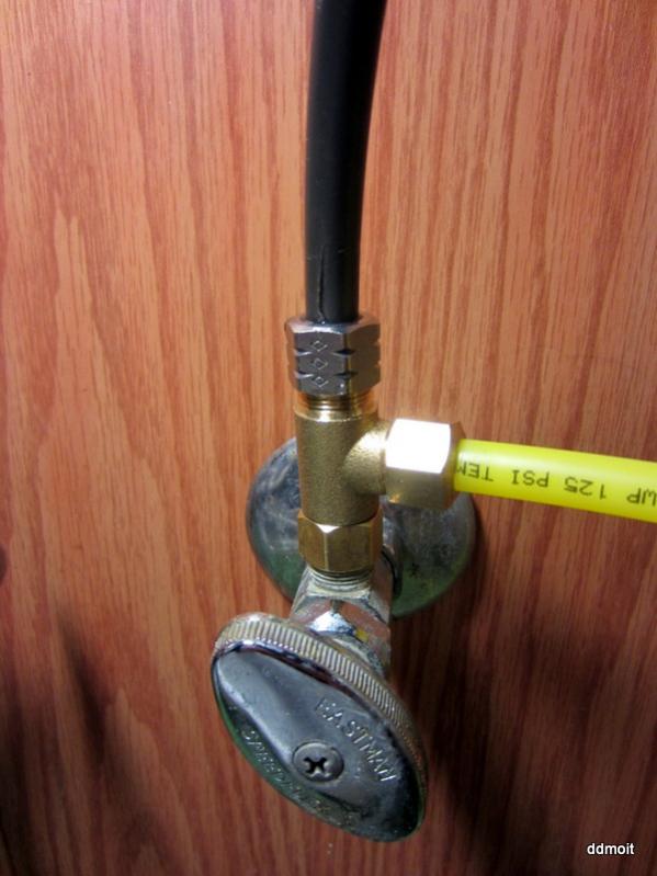

IMG_8097.jpg This is what I have. It fit my new Delta faucet perfectly. I can add a splitter to the top of the shutoff valve to connect my faucet and the water filter.
The adapter looks to be 1/2" pipe threads x 3/8" OD.
Your shutoff is 3/8" comp or also considered 3/8" OD
You may want to pick up a double shutoff for the wall fitting
or a 3/8 comp x 3/8 comp x 3/8 comp tee for the top of your current shutoff.

The triple 3/8 tee is what I ended up doing. I'm just concerned about the PEX compression fitting holding. I used a nylon ring, properly installed. I suppose it's no worse than the line going to the new Delta faucet. A leak would be bad in a hurry though.

Yeah, I actually have one. In all the excitement of putting it together, I failed to use it.
1,191
The inside sleeve provides a hard, smooth, round surface to support and mold the pex so the compression fitting will hold and seal properly. It is included for a reason, you should use it! The connection will be much more robust.

The connection Tee they gave you was to go between a "flexible hose" supply line and the 1/2" MIP threads on most conventional faucets. Delta, because of their DST versions no longer uses the MIP connection which is what caused your difficulty. The "Add-a-Tee" adapter you used is what I would have used also.
