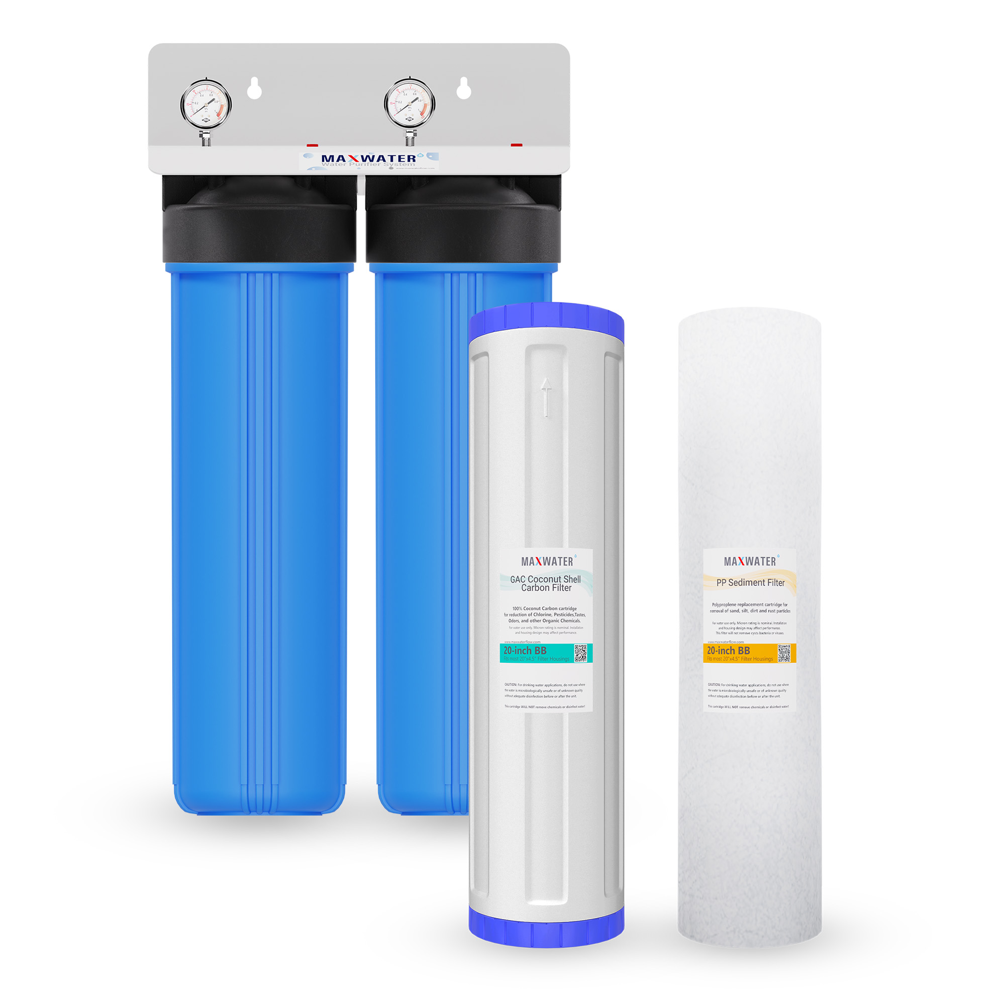

Am thinking on replacing with a whole house cartridge filter system (minimum two stage sediment and carbon block filters), but would like to get some opinions before I make any decisions. Looking round the houses in the area, there's a variety of different systems, but most seem to have the tank style filters, although some seem to have softeners and some don't. Reason I'm leaning towards a cartridge filter system is lower initial cost and easier maintenance over the carbon media filter I currently have.
Is it possible to replace a carbon media filter like this one with a cartridge system? Or with us being on a well, am I going to see filters clogging prematurely and have to replace them too often? I've been reading up on this and getting mixed messages and so wanted to put it to the forum.

Don't bother with cartridge filters, way too expensive to maintain. A backwashing carbon tank will be a much better choice. Your old one is nearly 20 years old... time to upgrade. You could alos keep it real simple, replace the head with the same head and re-bed the carbon.

My main concern for that would be just make sure to choose filters that flow enough water. I see plenty of reviews for 1 micron drinking water type filters that people put in their whole-house canister and then complain they have low water pressure.
I have a single 5 or 10 micron whole-house filter which flows fine, but a two-stage setup at the kitchen sink on the cold water line, with a .5 micron filter, and wow that's low water pressure on that one.

I was thinking 50 micron course filter and then a 5-10 micron filter with carbon filter combo. If you don't mind me asking, how often do you end up changing the filters?

Take a look a the Pentek DGD-5005-20 cartridge for the sediment.

Whole house filter is a 10" typical under-sink size. Same size as the two 10" ones before the faucet. So keep that small size in mind when I say I change it about once a month. But filter changing depends on how dirty your water is anyway.
The two 10" filters right before the sink, I could change the first, cheapie one every 12 months if I wanted but 6 is better. The second filter, .5 micron pricier one, the other two filters apparently get practically everything so that one I could leave in there more than a year if I wanted, at least from simply looking at it.
Filter recommendations generally say to change filters at least every 3 or whatever months due to potential bacteria forming. eh.
