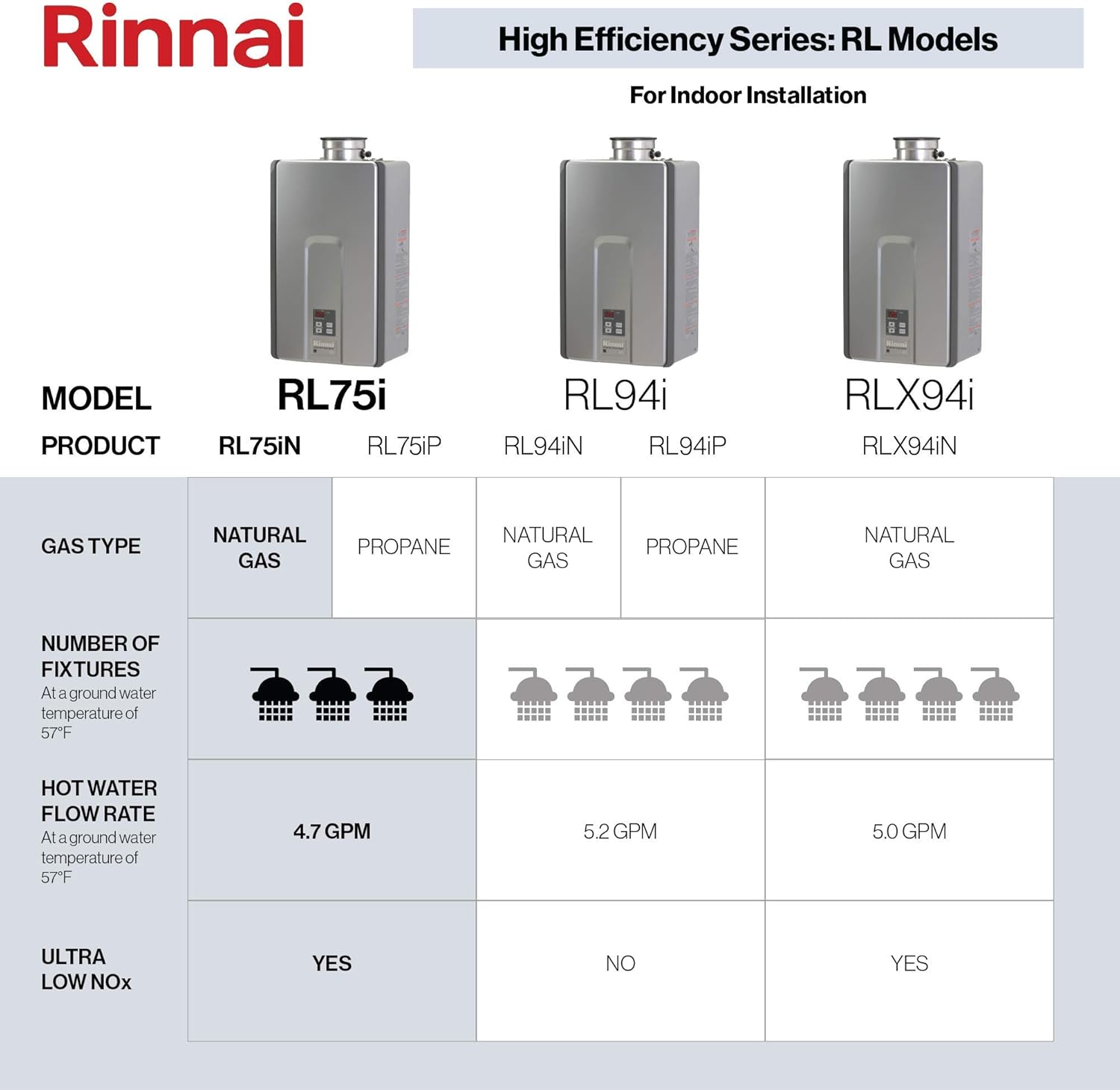

Ok I got some more information. so the first model on the left.
RL75IN Tankless Water Heater | Rinnai
CLH
47
Bentonville/Rogers Arkansas
I was concerned that 4/7 gals./min. would be enough. The tub spec’d is 15” water depth, 57+ gallons. It is a regular 30X60 tub but deep enough to soak in.

That tankless unit is not a condensing model so the gas efficiency is rated at 81% as opposed to 90+%. Probably not a significant issue as your Texas incoming water temp maybe 75 degrees + so the temp rise and gas usage will not be as significant compared to 45 - 50 degree incoming.
It appears the 4.7 gpm flow rate is based on a 63-degree rise (in 57 - out 120) but as your water is likely much warmer, the supported flow rate will be higher, closer to the maximum 7.5 gpm that can flow through the heater while maintaining 120 F output.
Filling a tub for immediate use will not typically utilize 100% hot water, but will use a blend of hot and cold. The tub fill rate will likely be closer to the flow rate supported by the home's plumbing and tub faucet.
