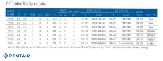

I found some replacement Sta-Rite (now Pentair) pump controllers. Here https://www.rcworst.com/vip-pro-series-controls.html
Now the issue is that I'm not 100% sure of which model controller I have. It's hard to read the tag. It looks like VIP4EC2-0. But there is no "EC" model - so it must be a "E0" (just a bad stamping), which would be a 1HP pump.
The main difference is the ratings of the capacitors (per chart below) - so I need to get this right.
The VIP4E02 is for a 1HP pump.
The VIP4D02 is a 3/4 HP pump.
The VIP4C02 is for a 0.5 HP pump, and
Not sure what size submersible well pump was installed (30 years ago). I may be able to pull the capacitors out and find a part number, which would then confirm what HP pump I have, but I'm not expecting to be able to rea any numbers of anything as bad as this box looks. And I don't want to have the controller fall apart (as I wont have water in the house) and then have to wait for replacement parts to be shipped.
