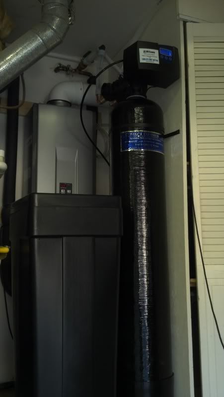

As a follow-up to this thread, I wanted to share some of the details of the installation.

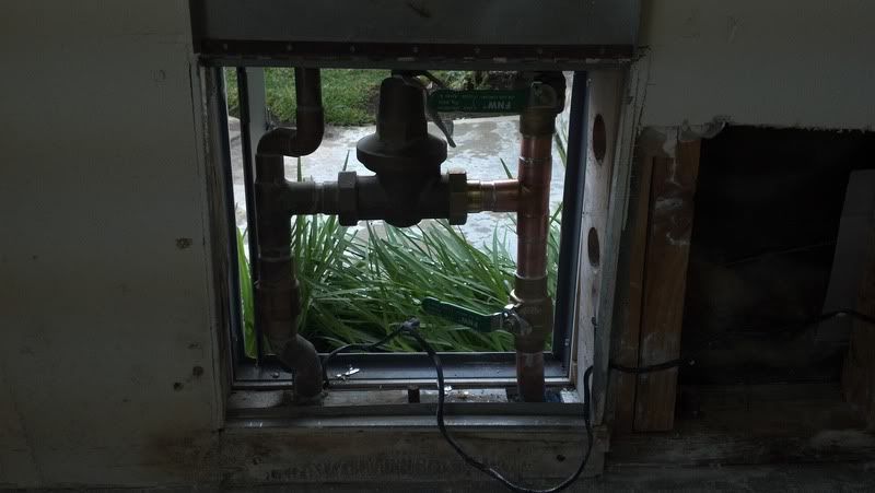

Bypass: I ended up installing a 3-way bypass, placing 2 of the valves at the main valve, and one at the softener as it back-feeds into the cold water input side of the water heater.

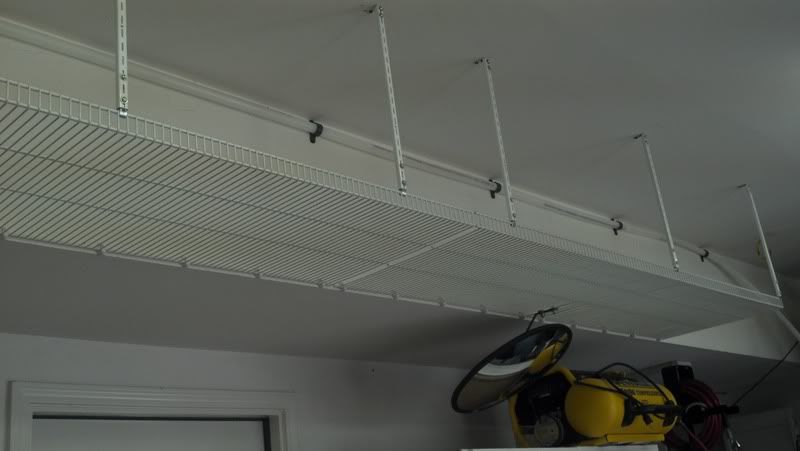

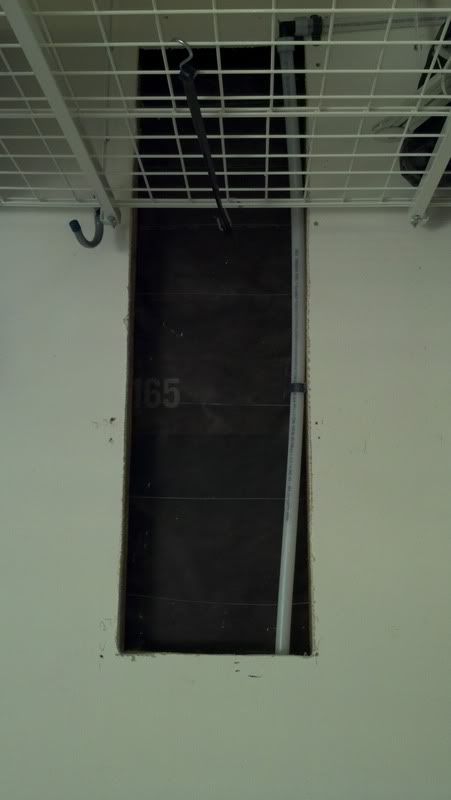

Line To Softener: The main valve is on the other side of the garage as the water heater and the softener. It's about a 30' run. I ended up running the line up towards the ceiling, and then along the ceiling, and then down to the softener. I decided to go with Pex simply due to the flexibility needed along the path (90 and 45 angles).
Water Softener: Went with a 1.5 ft^3 resin tank with a resin that's suiting to resist chlorine better, and a Fleck 7000 valve. The softener is located where the old water heater tank used to sit (prior to going tankless). The old platform was a bit too small for both the resin and brine tanks, so I extended the width of the platform a bit to accommodate the 2 tanks plus still give access to the tankless WH sitting behind the softener.

Main Valve:
Line running from main valve to ceiling (still need to patch the drywall)
Line running horizontally across the garage ceiling
Installed Softener
Thanks again for everyone's help!
