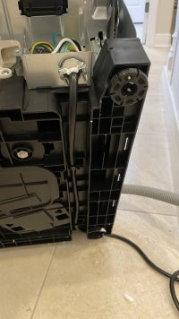

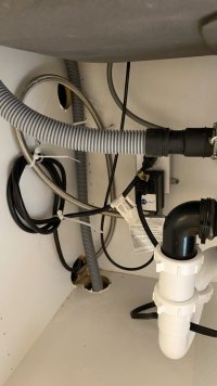

Install the outlet under the kitchen sink. Any surface electrical box will do with a GFCI. If possible do run a new cable with a ground if the existing one does not have a ground wire. If it is not possible, the GFCI comes with labels for a "non-grounded" installation. New dishwasher are not taller, only a taller door since it hinges closer to the floor. You need to purchase an appliance cord for the new dishwasher.

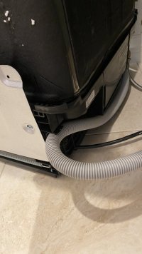

New dishwashers have no space under it for anything other than a power cord and water line including the rear of it. Dishwashers are packed with thick insulation and the bottom maybe boxed off for quiet operation. The is the my Samsung dishwasher I installed this past February. It was impossible to get the drain hose into the sink base cabinet from the side. I had to drill a hole below the sink base, then another hole into the base. When I did a remodel ten years ago, you can see I surfaced mounted the electrical box. The wire (UF cable) comes from under the slab inside the wall. Recessing a box can be a hassle if the studs don't line up.
