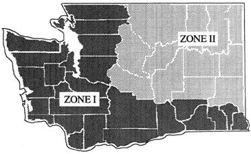

Seattle is clearly WA Climate zone 1:
-----clipped from the code
502.1.6.6 Walls: Walls separating conditioned space from
unconditioned space shall have a vapor retarder installed.
Faced batt insulation shall be face stapled.
EXCEPTION: For Climate Zone 1, wood framed walls
with a minimum of nominal R-5 continuous insulated
sheathing installed outside of the framing and structural
sheathing. For Climate Zone 2, wood framed walls with a
minimum of nominal R-7.5 continuous insulated sheathing
installed outside of the framing and structural sheathing. The
interior cavity insulation for this exception shall be a
maximum of nominal R-21.
----------end clipped code
This means that in Seattle either R13+5 or R19+5 is acceptable without vapor retarders, per-code. (But R13+ 2.5 is actually sufficient.) Over in Spokane (zone 2) R19-21 + 7.5 construction is acceptable, but R13 +5 might not meet code-min for R?.
T & G sheathing with asphalt paper has a perm-rating of about 5. Shingle siding (but not clapboards or ship-lap) is fairly well vented, and if you have at least 6" of roof overhang you'd be able to get away with 2+ perms on the interior. When in doubt, err toward the more vapor-open. (Kraft facers rather than vinyl or foil, vapor retardent latex rather than poly.) Most moisture problems are from air-leaks. Air-tight but vapor semi-permeable is more resilient.
