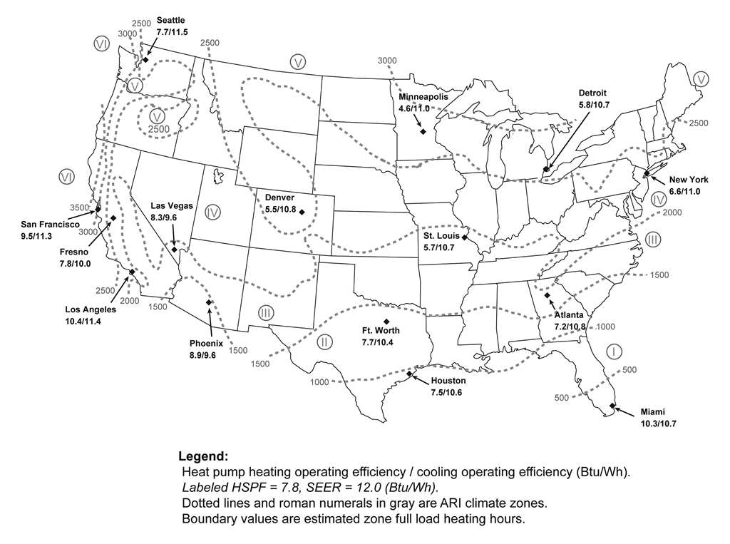

I believe the 11,000 BTU/kWh consumption rate for mini-split heating you provided above was at its rated heating capacity. For say the Mitsubishi MUZ-GE18NA 1.5-tonner, its rated heating capacity is 21,600 BTU/hr and power consumption at 1900 W - about 11,400 BTU/kWh. If I operate at its minimum heating capacity at 3500 BTU/hr during shoulder season, it consumes 230 W per its manual - that's 15,000 BTU/kWh or 35% more than its consumption at rated heating capacity. I am not sure how the condensing boiler consumption rate compares to mini-split during shoulder season. So I wonder if there is an optimal time to use mini-split heating where its cheaper than using condensing boiler.
Thanks,
Jerry
Dana
In the trades
7,889
509
01609
The GE18 with an HSPF of 10 (=10,000 BTU/kwh) is a lot LESS efficient than the FH18 with an HSPF of 12 (=12000 BTU/kwh) HSPF testing is the nominal efficiency when operated in heating zone IV (not to be confused with US climate zone 4, though you happen to be in both.)
That's fully 20% more heat per kwh going with the FH series, which makes a difference.
If your heat load is 30,000BTU/hr (but it isn't according to your calculations), for 55F delta, thats 30K/55F= 545 BTU/hr per degree F below 70F. The minimum modulated output is tested at +47F, which is a 23F delta, so ideally your mini-split would have a minimum modulation less than 23F x 545= 12,535 BTU/hr @ 47F so that it will be mostly modulating at part-load than cycling on/off at minimum load. Both the GE18 and FH18 would be fine. If you buttoned down the place and insulated to the point that the load was 20,000 BTU/hr you'd want a mini-splits that modulates down to below 8355 BTU/hr @ 47F. The higher 5,150 BTU/hr minimum output of the FH18 will not be a problem- it would meet or beat it's efficiency numbers in your application.
The "11,000 BTU/kWh consumption rate" isn't a consumption rate, its an energy efficiency rate. A kilowatt hour or BTU is not a rate, but fixed amount of energy, using two different setss of units, but are not time dependent. It means for every kwh the thing uses, it delivers an average of 11,000 BTUs, but tells you nothing about the rate at which those BTUs are being delivered. A coefficient of performance (COP) is energy-out/energy-in, but HSPF is a hybrid way to express the same thing, using watt-hours as the input energy unit, and BTU as the output units. The simple unit conversion of BTU to kwh energy units is 3412 BTU per kwh. An HSPF of 11 means it should average 11 BTU out for every watt hour in. Since electricity is metered and billed in units of 1000 watt hours (kwh), multiply by 1000, to get 11,000 BTU/kwh.
And the "rated" capacity isn't it's maximum capacity. It is the modulation level at which it was tested for HSPF efficiency. It's maximum capacity varies with temperature, and it's efficiency varies with both temperature and modulation level. The HSPF tests at a lower modulated output than the "rated" output at +17F than it does at 47F, and the performance data from both sets of temperature & "rated" capacity is fed into an mathematical model to estimate it's average performance in a zone IV climate. In the case of the GE18 it's rated capacity at +17F is an anemic 13,400 BTU/hr, but it's maximum @ +17F is only 17,200 BTU/hr,( which isn't even as high as they tested it's "rated" efficiency at +47F. Most models use the max output at +17F for the modulation level of testing at +47F, but here they probably chose numbers that would get them to an HSPF of 10.)
The FH18's internal controls inhibit it from delivering more than it's 47F "rated" 20,300 BTU/hr when it's +17F or cooler outside, forcing it to operate at part-load 20,300 BTU/hr at which it was tested at +47F., and higher efficiency, even though the same fans & coils operated differently could deliver higher capacity. Even at +5F it can still deliver 20,300 BTU/hr, but when it's colder, it may not, depending on outdoor humidity, etc.
The HSPF test was designed for single stage & 2 stage ducted heat pumps, and don't accurately reflect the potential for savings with fully modulated units. The COP of the FH18 at +47F is 3.46 even when delivering the full "rated" 20,300 BTU/hr, but at a modulated 8355BTU/hr or 12,535 BTU/hr it's COP efficiency will be over 4. The referenced bench testing document was done on older 1-tonners, but the characteristics of higher efficiency at part load is true for the 1.5 tonners as well. The "rated" level of output was about 2/3 the maximum at +47, but in your case you would be operating at about 1/3 the rated output, give or take, and probably operating in the COP 4.5-5 range with the FH,18, 4-4.5 range with the GE18 until it's warm enough that it's cycling a lot rather than modulating.
