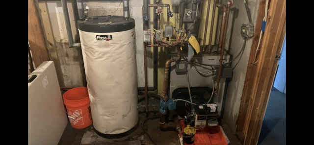

Okay guys so I bought a house in Jan. My indirect started leaking so I’m looking to replace with an Electric Water Heater due to wanting to keep the boiler off during summer months
I know I can just buy another indirect and just basically plug and play with the existing connections.
can anyone give me a quick run down on how to make this switch or is it even possible.
Thank you.
I have this boiler.

Indirect where is it exactly? At boiler or tank? Take a pic. Electric would just have to pipe the cold and hot water lines to the correct lines. Can get rid of the indirect tank.

This is my current set up.
1,193
Swapping to an electric WH isn't a big deal, but depending on what your fuel use is, and the type of boiler, it may not save you much. Keep in mind, that an indirect typically has a MUCH faster recovery rate versus the typical electric one, so you might need a larger tank. Many more modern boilers are designed to cold start, so that means in the summer, they only turn on when the WH calls for heat...IOW, they're not running in standby, already hot.
Do you have a spare 30-40A in your panel? You might consider a heatpump WH, it's more efficient than a pure resistance one.
The heat pump water heater (HPWH) idea would be a great if he hadn't already bought the plain old electric tank... :( Consider it an opportunity loss.
Or maybe not.
If it hasn't already been unpacked it may be returnable for a restocking fee, or even for store credit against an HPWH.
The summertime outdoor dew points in Carmel NY are high enough that basements generally need mechanical dehumidification to keep the musty basement stink at bay, and a heat pump water heaters take on some of that dehumidification load, converting & storing the latent heat of vaporization of the moisture in the air into heat inside the insulated tank.
During the heating season the HPWH harvests the standby & distribution losses of that (surely oversized) boiler, storing it in the tank. Lowering the temperature of the boiler room a degree or two in winter lowers the overall heat loss out of the house, for higher net efficiency.
Any time of year any standby losses of the HPWH get restored back into the tank at 1/4-1/3 the cost of replacing that standby loss heat into the water with a resistance element.
With a plain old electric tank you get none of that. The operating cost of a current model HPWH is typically under 1/3 that of an electric tank, and a cheaper way to heat the domestic hot water than almost any other method (including condensing natural gas.)
