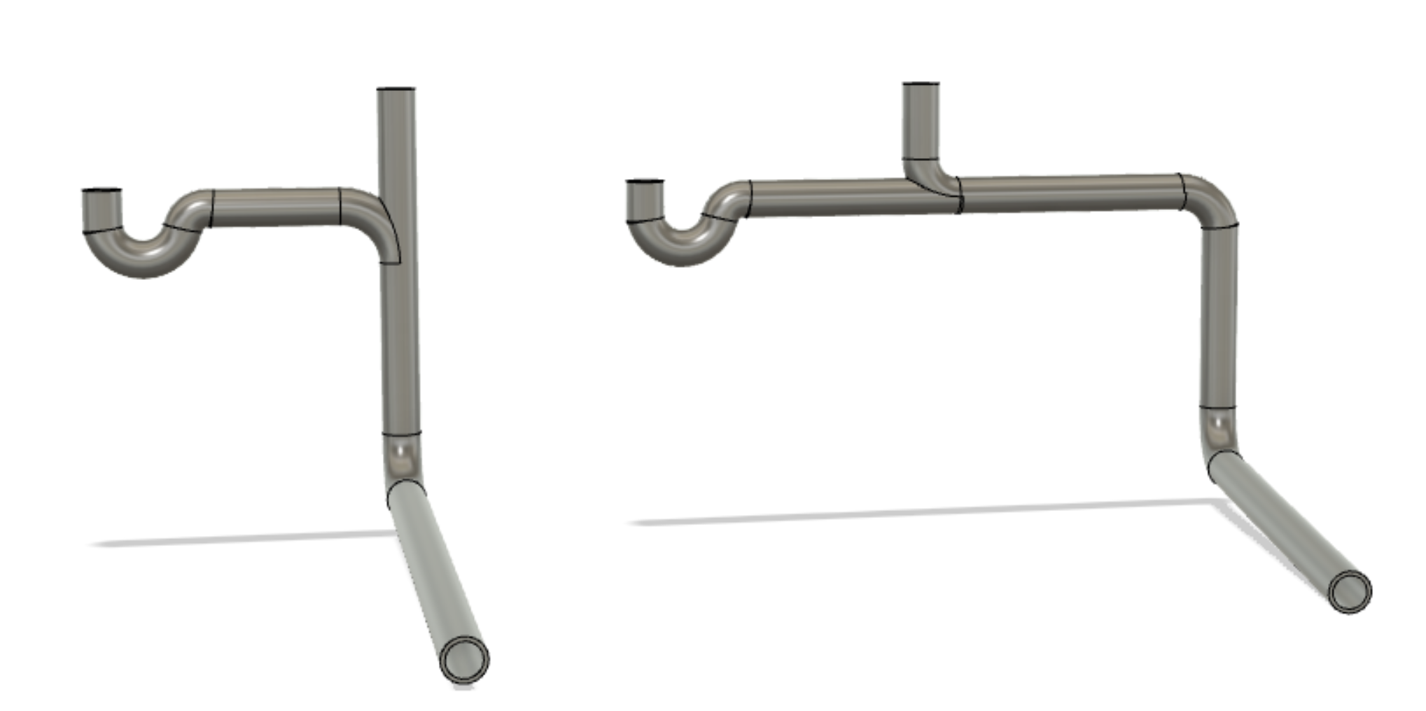

I am re-doing the kitchen and "while I'm at it" I figured I could improve the basement by moving the sink's drain line over by 4 ft. Here's a proposed before/after pic (not to scale):
In the basement below, this would move that pipe over from the middle of the room, closer to a wall (and closer to the sewer line it empties into). I really just want to verify that this is okay to do. The kitchen and sewer lines are on opposite corners of the house, so that horizontal line is 25ft long and must drop quite a bit over that distance, nearing head height. Much less obtrusive if it starts closer to the wall (and I realize I'm losing an inch by pushing it orthogonal before it cuts across, but the existing pipe drops down by an extra 4 inches before the sweep 90, so I'm curing that also). Thanks in advance.
