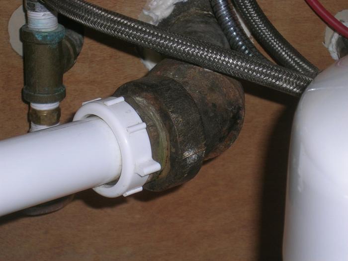

Hi there,
Here is a picture of the drain's current hook-up in our kitchen sink.
I have been wondering--if it is a good hook-up.
The reason is that
1. The CI elbow is a 45 degree elbow. Is that a correct elbow--or should it be a 90 degree elbow?
2. And then the extension used by the installer is a flexible plastic pipe. That turn is also an odd turn. Perhaps it's due to the 45 degree CI elbow joint.
I wonder if there is a better way this can be done, like
- changing the CI elbow to a 90 degree, or
- just make a cut on the CI pipe before the elbow, do a coupling to change out to plastics, and make a 90 degree turn
BTW, is the CI elbow joint a lead joint?
Thx... .

What an abortion. A better question would be, "Is there any way it could have been done WORSE?" The 45 IS the correct turn, but everything ahead of it is WRONG. IF the pipe from the disposer to the tee flows DOWNHILL, then it is a simple matter of cutting off the trap's outlet tube and positioning the trap UNDER the tee. Then cut an "extension tube" to size and place it between the trap and the tee.

That flex pipe is disaster waiting to happen as well. Just because a store sells them doesn't make them acceptable. Your question tells me that you have zero knowledge about how do connect a drain. My best advice to you is to call a plumber to redo this mess properly.

Shorten the trap arm and swing the trap to get rid of the offset. I would get rid of the entire set up and redo it with glued fittings though. Garburators tend to loosen those connections with the vibrations over time.

Replaced the flexible extension with a rigid one. Looks better now.
BTW, another newbie question... :
Is this the right way to hook up the p-trap outlet to the CI elbow (slip joint)?
What'd be the right way if this is not?
Thx... .

Shortened the p-trap's outlet arm a bit further so it won't protrude to the left front (a bit more room now in that area... ).
No idea why the installer had that flexible extension like that in such an odd way. Anyway, should look ok now?
Assuming that the outlet arm's slip-joint to the CI elbow joint is good. Looks like there's an adapter right there so to match up to connect to the slip-joint (2nd pic in previous post)... . Metal thread to the plastic slip-joint's nut is ok?
Let me know if anyone spots anything else not right... .

That was becauses whoever installed it must not have known how to cut off the trap, the way you did. My only changes would have been to use a metal slip nut on the 'trap adapter" instead of a plastic one, and eliminate that double slip joint coupling and use conventional long extension pieces like the one you used between the trap and the tee.
