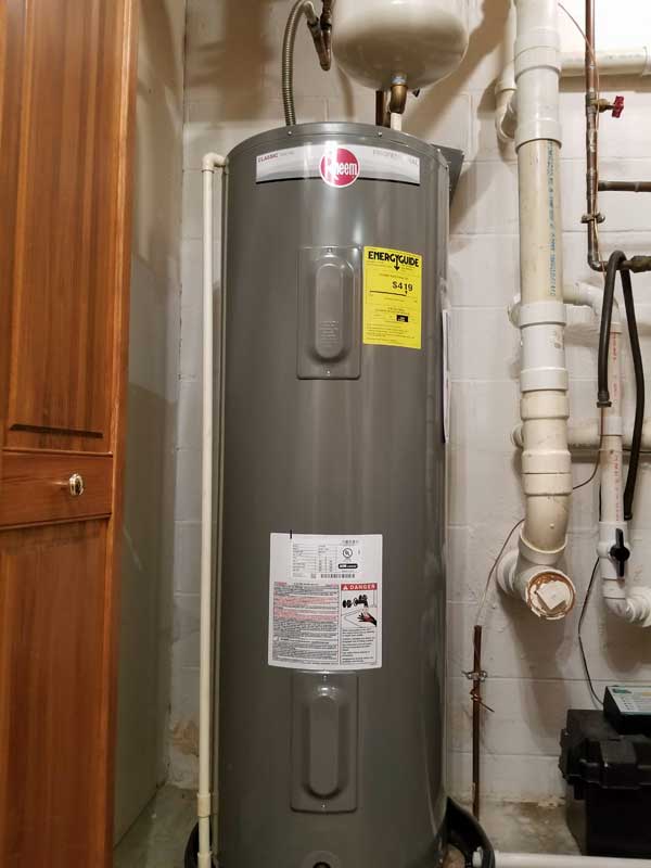

we installed a 2017 rheem electric heater that just started leaking last friday....
it has a thermal expansion tank on it...... it has soft water
but it does not have a prv valve,, but it still leaked after just 3 years...
I noticed that someone installed a water softener and used sharkbites to break into
the water system to install the unit... I know that sharkbite fittings work great but they
can actually break the grounding in the electrical system and cause troubles....
we determined that the grounding into the home might be the issue so
I drilled a hole in the basement floor and installed a copper ground and
clamped all the copper pipes nearby the heater in series and down to this
ground rod.....
They got a new heater under warranty.. here is a link to the new heater which you can see the
heavy copper wire grounded to the system and to the concrete floor
only time will tell what is going on in the home
https://photos.app.goo.gl/gqRrxjRCe9SdjoUA8
