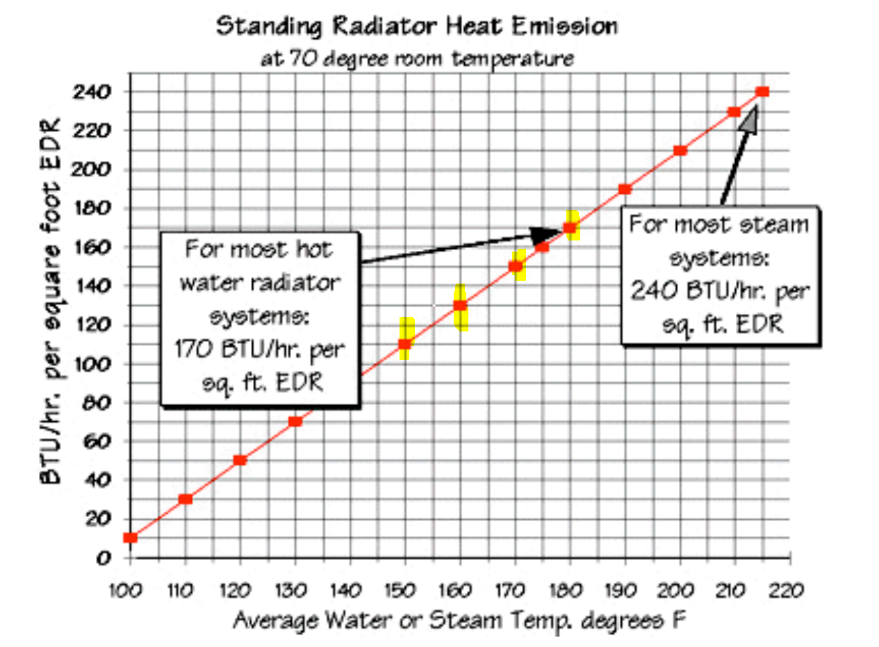

At an AWT of 130F (135F out, 125F return) the rads would be putting out about 70 BTU/hr per square foot EDR, and the boiler should be delivering about 90-91% efficiency if running in it's low-fire range.
580' EDR of radiator x 70 BTU/hr= 40,600 BTU/hr
A reasonably tight but uninsulated 2700' house that still has some single-panes would typically have a heat load of ~50-55,000 BTU/hr @ 0F outside, but probably not as high as 65,000 unless it has HUGE air leakage. A load of 50,000 BTU/hr with 580' EDR of radiator is a ratio of ~85 BTU/hr per foot EDR, which it will deliver at an AWT of ~135F:
Looking at Figure 87 on p.65 of the manual when running on curve 5 it should be delivering 135F-out when it's in the high 20s or low 30s outside. But curve #3 would deliver 135F out at about 0F outside, which is pretty close to where I think the heat load is with the house in it's current condition. Try dropping it down to curve #3 to see if it keeps up overnight (it might, but might not). If it doesn't keep up, bump it back to #5 until the house gets back up to temp, then drop down to #4 to see how it does overnight.
But whether it's going to take curve 4 or curve 3, either would be fine to run in most staple-up (even plated) radiant systems without mixing it down. Most PEX is rated for 180-200F max, and you won't be needing anywhere near those temperatures on your system unless you're keeping it 85-90F indoors to keep your tropical orchid collection happy.
Given the relatively modest water temperature requirements even BEFORE improving the insulation & air sealing on the house I don't see much point in mixing down the temperature for the floors. The only floors that can't take 150-180F water would be concrete (which could crack from the thermal stresses.)
