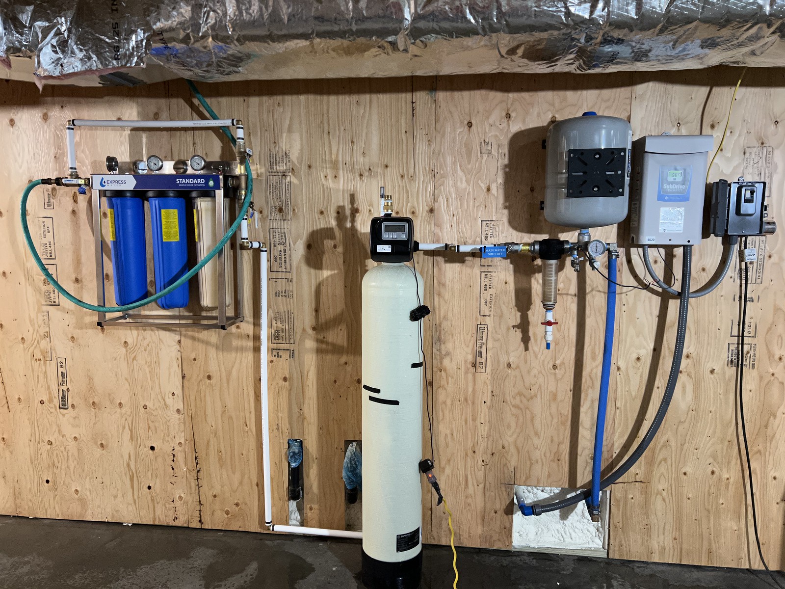

All installed. 0 PPM Iron.
All went smooth. Except when slow backwashing I was at 7.5 gpm and the media was extremely high in the tank. So I opened where you put the DLFC and it had the 13 gpm. So I put the 11 gpm in. Measured flow and it went UP to 10 gpm. Then I noticed media was coming out. Ugh. Slowed down again and it was stable and was still at 10 gpm.
All I can think of is the “dust” was trapped in the media at the bottom and when I restarted with smaller DLFC I opening things to fast (because I thought I was done) and it kicked up a storm in the tank.
After that cleared up I was getting about 4” rise in a 10” tank while back washing with the 11 gpm DLFC. My calc says that’s about 12%. Min is 15%. So I put the 13 gpm DLFC in again. Still close to 10 gpm. But media did rise about 1” and that made it 5” rise which is 15%
My hose I’m backwashing with is a little restricted. Once I get the 1” Pex drain in, I think it will be a little better. My guess is I might hit 12 gpm.

Nope media rose like 100% or more at 7.5 gpm. And it was just a few inches from the top. It was that way for like 30 minutes. So it was not a cloud or dust.
You can see tape on the tank of low and high marks (now towards end of process). It was WAY above those. I don’t know what happened.
So I stopped, switched from 13 to 11 gpm.
It rose up again and now I was at 10 gpm. But I decided it should be safe. And let go. Next thing you know media is coming out.
So I slowed it WAY down again (less than 1 gpm) and started over (with a slow backwash). Probably 4-5 hours of slow back washing and ramping it up.
Then things looks normal.
Not enough rise, so I put the 13 gpm back in.
Still getting ~10 gpm but the rise is now 15% (or 5 inches).
What I lost in media was small. Maybe 1 quart.
Is it normal to lose some? Maybe some light bits had to rise and flush out and that’s what I was seeing when it was high?

It is normal to backwash fines out, expecially with new media.
From a terminology point of view, and easy numbers, let's say the distance between the domes is 48 inches. The media would normally come up 32 inches when sitting there. If the media rose to 8 inches more, or to 40 inches, that would be called 25% bed expansion. At 50%, media would blow out the top.
Anyway, if your media was stuck before, it's not now. That's good.

I think “the fines” as you call it were hovering high at 7.5 gpm. Not enough to flush them out. Once I restarted I think some stuff low in the media bubbled up and then the flow rate increased (regardless of which DLFC button) and it flushed out and things stabilized. I ran several regen cycles. And it all looked good.
I’m pretty sure I can get it up to 12 gpm or higher. And get the expansion up a bit.
I had a shut off on the hose. But I think that is wider than the DLFC. But I think a clean run of 1” Pex will help the flow a bit. I have not even tried to increase the pump constant pressure. It held steady at 50 psi while backwashing for hours. So that was all good.
I need to add a dry well to drain now. The House is still being built. Trying to figure out how to get outside without freezing (I’m in NH) and not have to drill a hole through foundation below frost line and potentially let water in. Rather come from above and go down hill into dry well (outside). Was thinking of running like 3” PVC then slide 1” pipe with insulation around it, inside the PVC. Something like that.

So I finally got a chance to put the 1” Pex backwash drain in.
Holy smoke what a racket. It went from 11 gpm to 15+ with the 13 gpm plug.
I had the same issue again that the entire volume turned dark ( only 5 min of filtering) and I lost a little bit of media again.
I put the 11 gpm plug in and it came down to 11 gpm and the expansion is still quite a bit more than the hose.
I’m thinking of making the first few feet of drain heavy duty 3/4 garden hose to tame the noise. I clipped the line to the ceiling which is the main floor.

After reading #11, I did not think you would be putting the 13 GPM DLFC again. Your media has clearly not been stuck lately. I am thinking 30% to 35% bed expansion would be a good target.
At the end of backwash, do you get a glug glug sound?

I think I kind of convinced myself everything was fine with the 13 and it was the burst of a first strong back wash that stirred things up a lot even though I had brought it up VERY gradually. Once things settled down I had put the 13 back in. But it was still restricted because I was using a 3/4" hose. I had done like 6 back washes (once a week, water is not being used but I still back wash it once a week manually to not have problems).
But I was a bit surprised how much difference it made going to the 1" with the same plug.
I suspect again, it just stirred things up again on a first backwash at this higher rate. And I suspect 13 button (~15 gpm) would be safe. But feels overkill.
The first time some media came out it had some grit. This time it was super fine particles and both times I see no difference in level when it's filtering.
