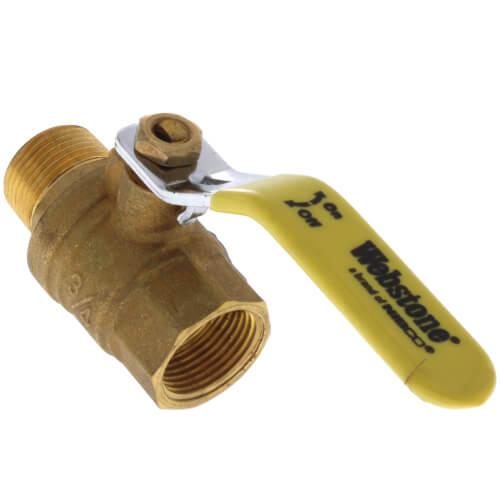

Something like this -- 3/4" MIP x FIP Full Port Forged Brass Ball Valve?

Thank You so much. I knew there was an easy fix, i just couldn't find it online.
Next question, what kind of water heater connector should I use. Should I stick with the copper line or with a steel one?

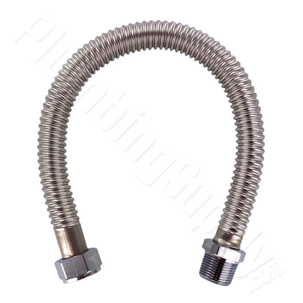

You can also get flex lines that look like this, which would eliminate a nipple if you choose a FIP FIP valve:

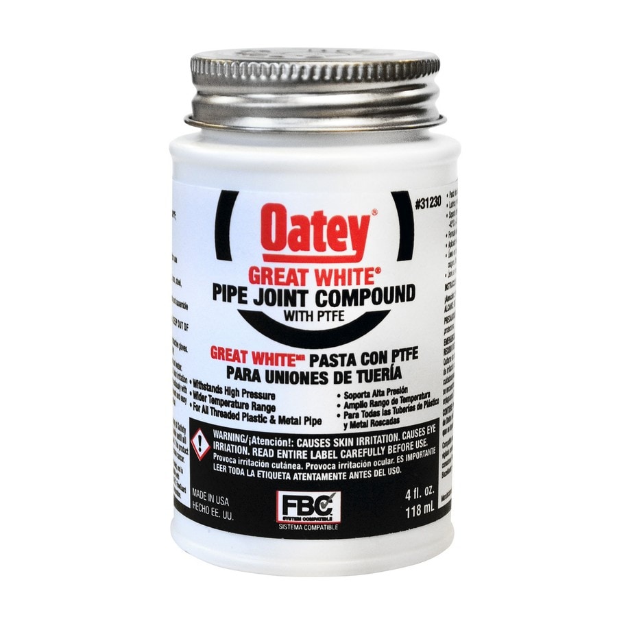

Thank you so much, I wanted to do it right and not use that copper coupling. As far as the nipple, just thread it with teflon and I will be okay right? I already hooked up the gas line and use sealant "putty". Can i use it on the nipples as well instead of teflon?

I couldn't find the "3/4" MIP x FIP Full Port Forged Brass Ball Valve" at Lowe's, so I got a FIP xFIP instead. That's why i'm using the Male x male nipple.

I don't know what your sealant putty is; it may be pipe compound. On both sides of the valve in your drawing, you can use either PTFE (Teflon) or pipe compound (such as Rectorseal #5 on metal), but there is some advantage to using both.
On the gaskets on the flex connector, you can use a bit of silicone grease. I would, but most don't.
Without addressing the water plumbing questions, I wanted to respond to the gas plumbing mention. It is absolutely critical to get right & super dangerous if you don't.
For sealing the gas line, you would use only gas rated pipe dope. Hopefully this is what you mean by "putty". Do NOT put plumber's putty on there and think it's the same thing. Gas rated pipe dope only, and always check for leaks using a leak detection compound at minimum.
Also, flex lines are typically installed differently than pipe nipples. Flex lines have a "flare" fitting and usually the manufacturer will specifically say to NOT put pipe dope on a flex line connection, as it can supposedly interfere with proper sealing. (This may start a debate as some people put a dab of dope on anyway; I'm not taking a position, just relaying what the flex line manufacturers usually say in their instructions).
