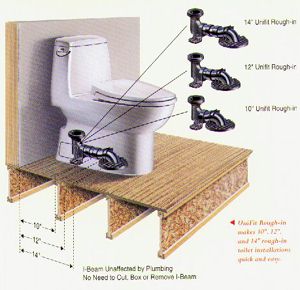

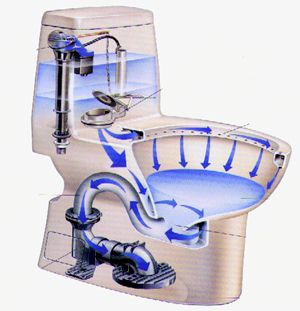

The Unifit adapter The skirted toilet design offers the use of a patented modular
rough-in system, which has been popular in Asia, called the UniFit Rough-in. The
system includes an interchangeable part that replaces the lower half of the trapway,
adapting the toilet to either a 10", 12", or 14" rough-in. |

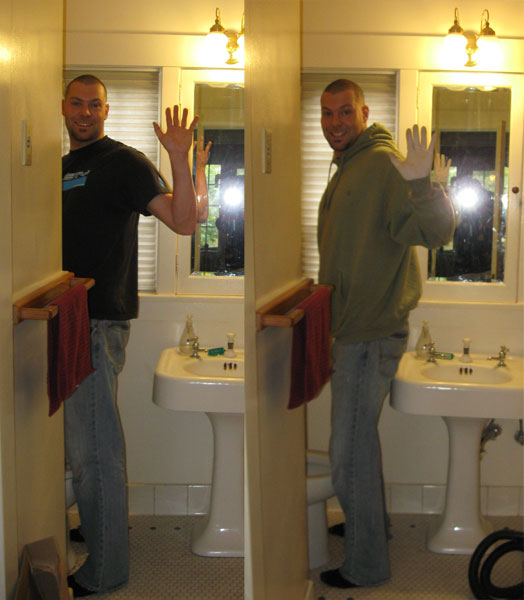

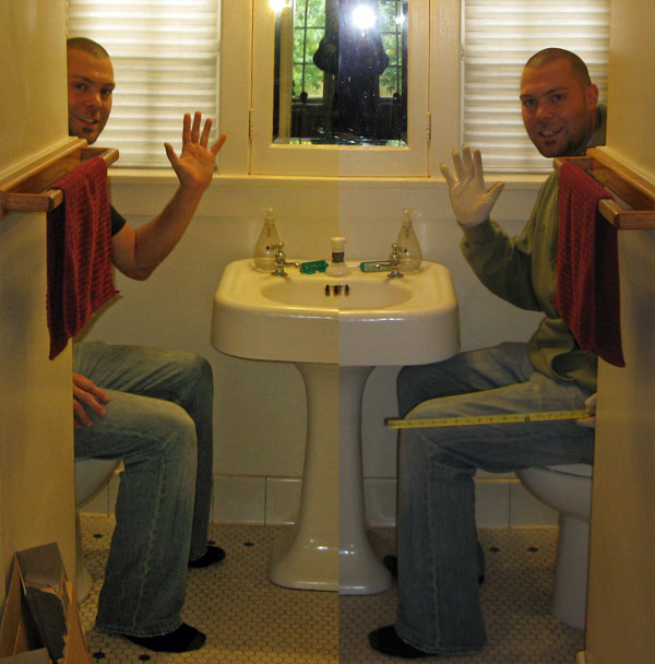

James demonstrating in an old Seattle home that has a 14" rough-in.
The toilet on the left is a Toto
Soiree with 14" Unift, the toilet on the right, is a Cadet 3 elongated
bowl.
Both bowls are elongated, but you can see how much leg room is gained by James
on the Toto. Several inches!
It's also much easier to use when standing up. His butt doesn't hit the pedestal
anymore.
Same bathroom, different bowls.
We sell a lot of the Toto bowls with 14" Unifit adapters in Seattle.
It
just makes sense to pull the bowl close to the wall, and have more leg room in
the bathroom.
The style fits the old Seattle homes better too.
On the left is a TOTO
Soiree with a 14" Unifit adapter.
On the right is a 14" Cadet 3.
Notice how little room there is with the Cadet 3 in this small Seattle bathroom.

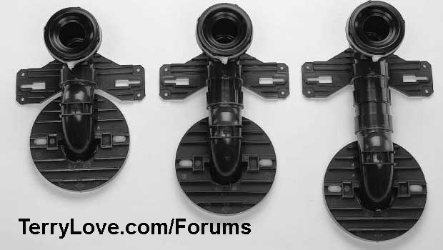

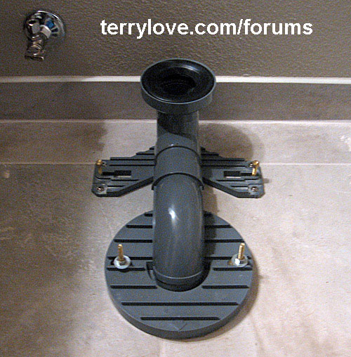

If you have a 14" rough, you can switch
for a 14" Unifit and keep the distance to 28-3/4"
The 14" Unifit needs to be ordered in addition to the toilet.
They come with the standard 12" Unifit, which winds up being an extra
part.
And no. I don't need anymore 12" Unifit adapters.
