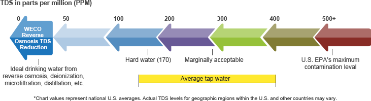

There is no other real alternative to reverse osmosis if you want bottled water quality out of the home faucet. There are newer ro systems with 1:1 efficiency like the VGRO-75. No other type of filter will reduce total dissolved solids (easily check with a pocket tds meter) below 50 ppm.
