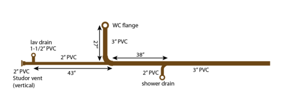

Wet Drain review needed
liber-fluxus
Asheville, NC
Hello folks,
Adding in a full bath on the second floor of a home, with all complications and restrictions that entails. I was hoping for some feedback about my plan, especially about the adequacy of the wet vent.
Thank you!
