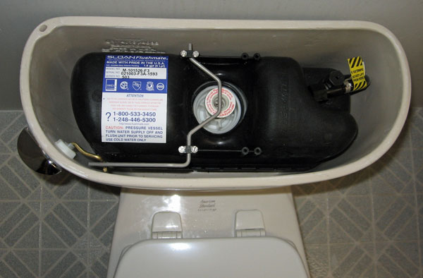

If it's a pressure assist in the tank, where compressed air is used to force the flush, then those will be noticeably louder.

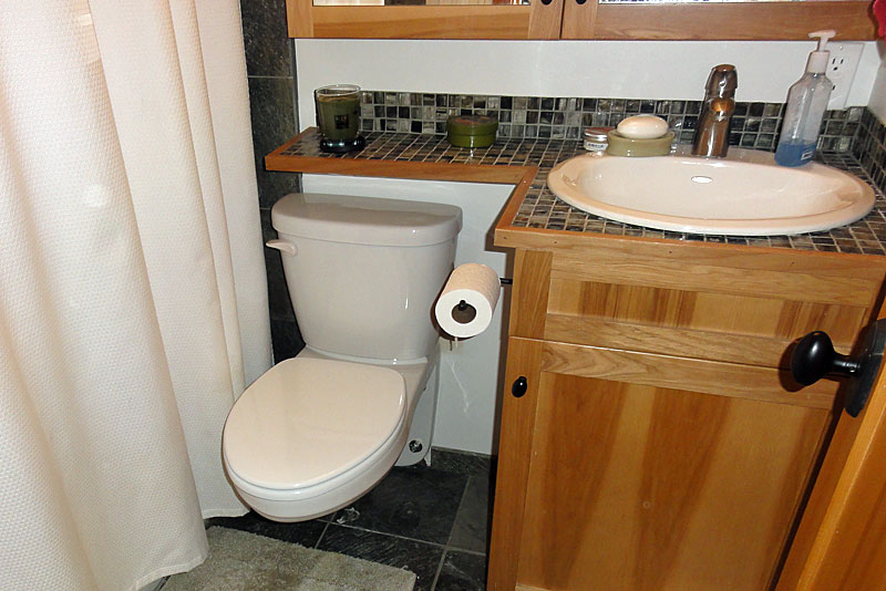

I was replacing toilets at the Crystal Mountain Ski area in Washington State,, and they pretty quickly decided that there would be no more pressure assist toilets there. Many of the bathrooms are back to back, and we found that the Gerber Maxwell wall hung toilets worked well with less noise.
Gerber Maxwell wall hung, with the gravity tank.

American Standard Glenwall wall hung with a pressure assist Flushmate.
A/S Glenwall is a noisy flush.
