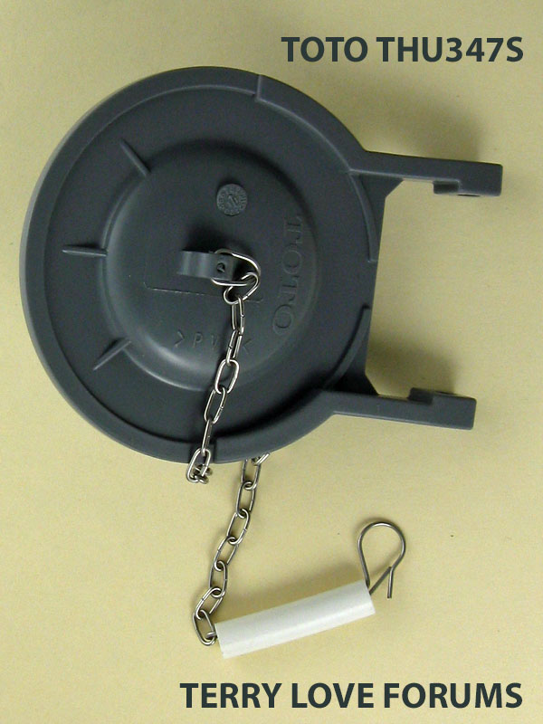

I've put two new flappers into my Toto toilet (Carollton model) to deal with an intermittent leakage from the tank to the bowl and still the problem continues. A call to Toto's customer support suggested that there might be smutz on the rim of the tank's drain hole so I scrubbed it with a scouring pad but no improvement.
After flushing, the tank fills normally and then some time later, the tank is heard filling up a bit more in response to leakage from the tank into the bowl. This continues indefinitely. The flappers were pink flappers bought at a plumbing supply store for this model toilet and represented to me as Toto brand, although they were not in a labelled box or wrapper. The Toto rep verified that the pink flapper was the correct one for my Toto model.
Anyone have any suggestions?

The good news about the Totos, particularly the G-Max, seems to be that good generic parts that work in them are readily available. If you're pretty sure it's the flapper (and not the chain, which is a very good suggestion), just go to HD (or Ace) and get the Korky "Fits Toto" Red flapper (part 2021bp) -- there's a blue and a red and the Carrollton takes the red. It's a manufacturer-approved part in lieu of the Toto THU175S, which is the official part on your toilet's parts list. Your toilet model number is CST774S... so you can see on the Korky box for the Red Fits Toto flapper that it's for your toilet. I have actually had some fun changing out the guts of my toilets, so I would probably start by pulling the tank, pulling the gasket off the flush valve nut and seeing if it seems like water is leaking out through there, and checking the tightness; I notice that Jamie Love, in his piece on installing a Toto Drake, recommends that you use pliers to snug up that nut before installing. (I use 12" channel locks which are perfect for this.) If it isn't that simple, I might just change out the whole flush valve -- the official Toto thing (THU129w-2a, just search on that) for $19.20, including the valve and the flapper, and they usually ship my stuff the same day. It's certainly an easy project to do, and then you'd just be done with it.

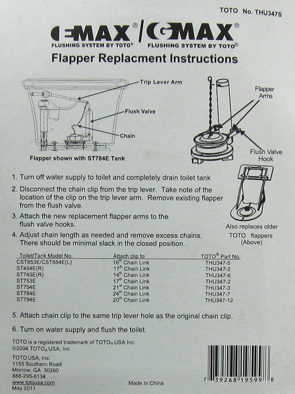

Great! Do let us know. Also, I know you know how to install a flapper, but do read the Korky instructions, if for no reason other than they are always wonderfully-illustrated and well-written, a real pleasure in this world of poor instructions. Terry often comments on how professional plumbers sometimes botch things because they don't bother to read instructions; in one memorable post, he commented that the job botched by the plumber in question required two simple tools that the plumber didn't use, a TAPE MEASURE and READING GLASSES. :D So I now always heed Terry's advice to read the directions, even if I assume that I know what they are.
Here's a link to the Korky flapper instructions (Hey, Look! It's your Carrollton in the illustration! [and these are a lot less complex than their directions on how to overhaul everything in the tank, which are great, but so be it]):

The easy fix (still with fingers crossed because I just tried it ten minutes ago) was to take a wide zip-tie and use it to keep the rubber flapper arm on the inside of the pivot shaft. (On the flapper, locate the rubber arm closest to the bowl. Slide it towards the fill tube and then use the zip tie to keep it from sliding back. You could accomplish the same thing with a washer or anything else that keeps the rubber arm from sliding back along the plastic shaft. Just do the one side that's closest to you.)
Okay, I've tested it three times now and it seems that the problem was the off-center flapper.
