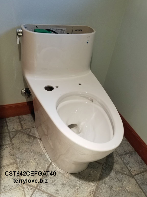

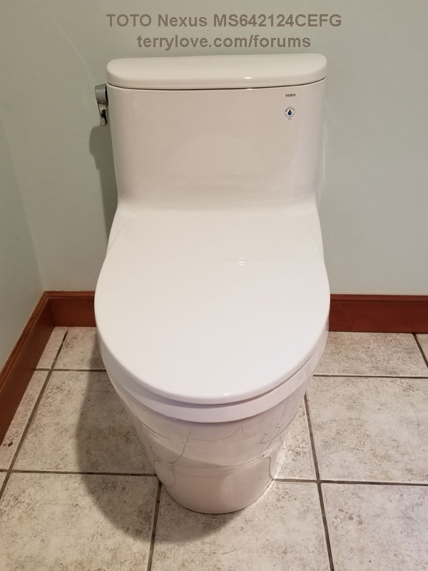

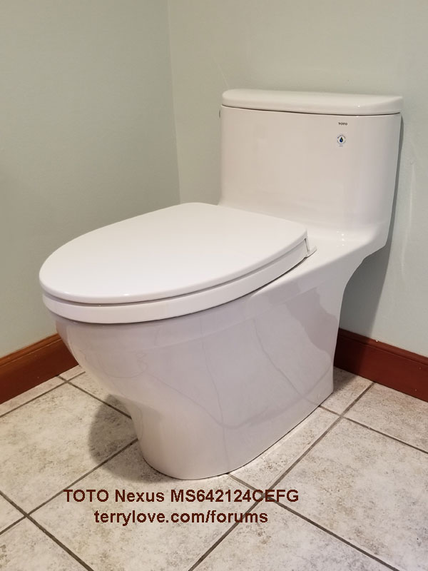

TOTO has a new Nexus toilet out now. It comes in 1.0 GPF and 1.28 GPF, a skirted bowl, and Tornado flushing. It's a universal height bowl at 16-1/8" before you add the seat which makes it an ADA bowl. It comes with it's 12" Unifit and you have the option of installing it with the 14" Unifit for an added expense.
The photo here is before the bowl has been caulked to the floor.

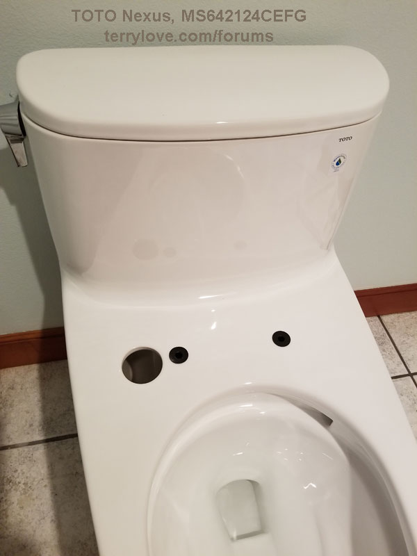

MS642124CEFG-01 TOTO Nexus
It comes as a Connect bowl in case you want to add a Washlet with concealed connections later.

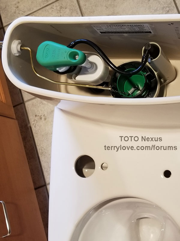

Looking inside the 1.28 tank with flush valve.

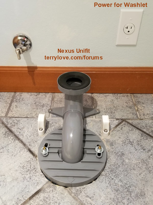

This is the 12" TSUW.12 Unifit that comes with the toilet.
Notice the blocks that attach to the floor for the side mounting screws.

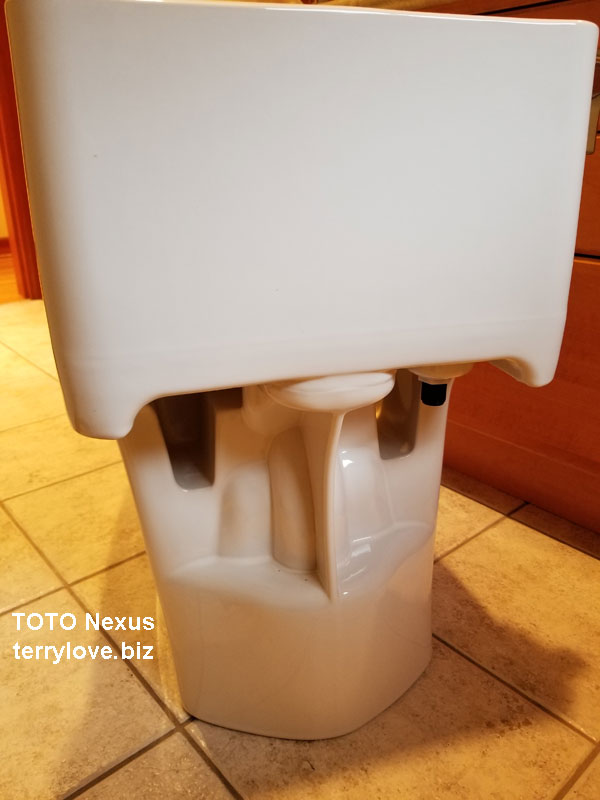

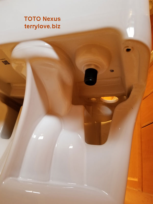

The back side of the bowl.

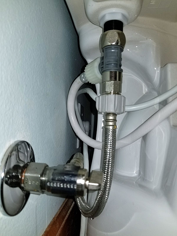

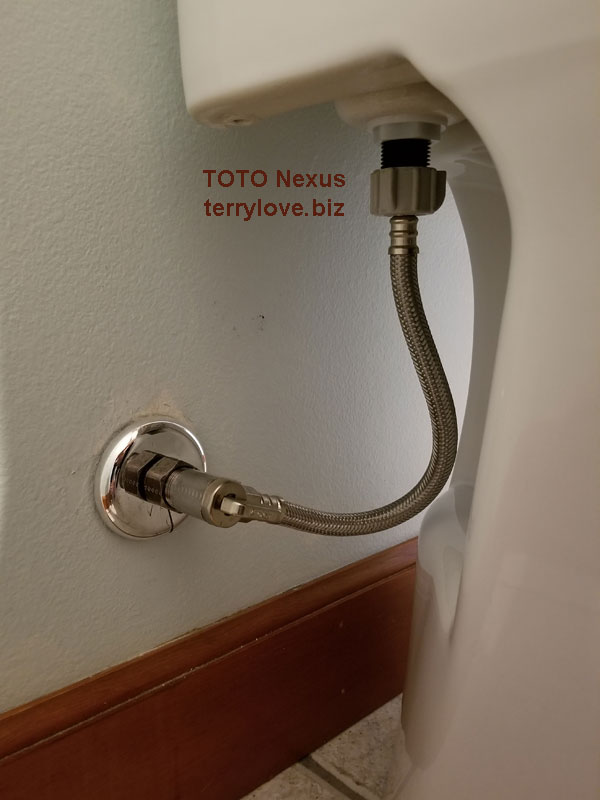

Connecting to the fill valve.

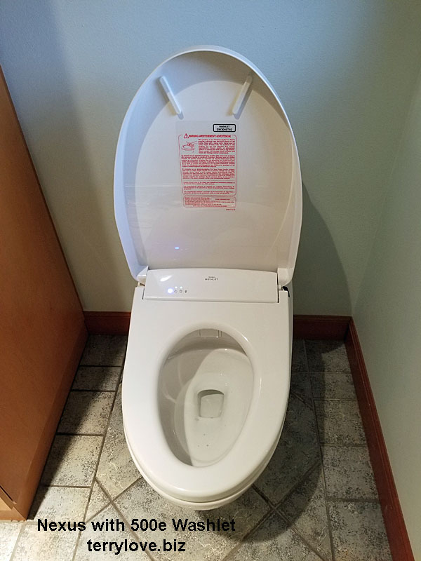

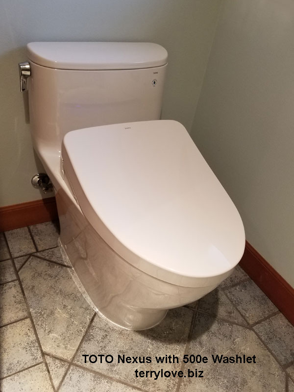

And done.

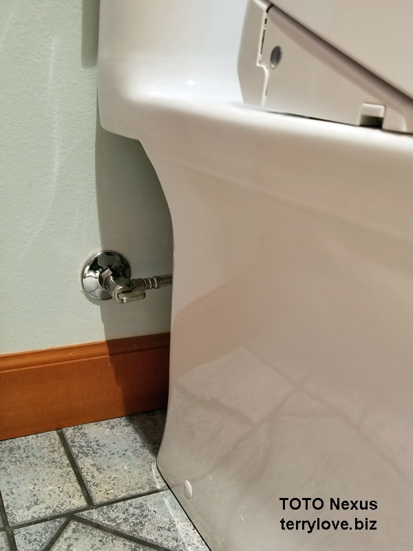

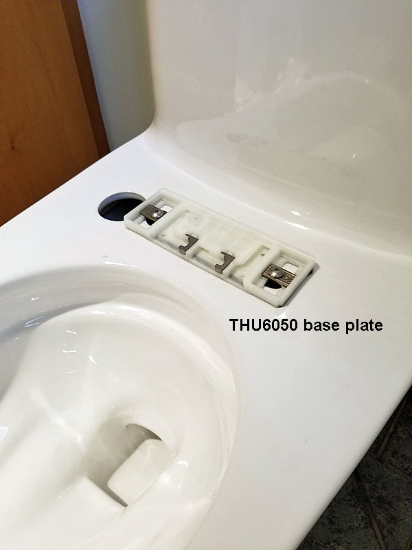

Installing with a Washlet in mind.
THU6050 base plate for the Washllet
I guess this all gets tucked behind.
TOTO Nexus CST642CEFGAT40 and SW3046T40 Washlet
