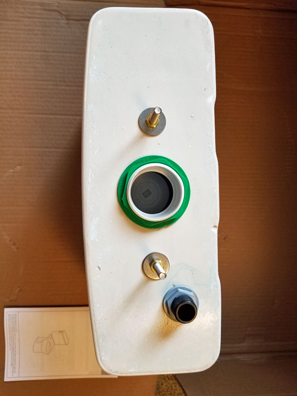

As the last item in our recently completed bathroom remodel, we decided to get a Toto Washlet C5. I assumed that it would fit on our existing Kohler Santa Rosa toilet, which it does not. The one-piece design won't allow the Washlet to be mounted far enough back. As pointed out in other threads, it's hard (at least I couldn't do it) to find Toto toilets with the T40 hole that aren't also sold with a Washlet. I downloaded a number of spec sheets from Toto's website for their Washlet-equipped toilets and found a bowl / tank combo that we like. Each is used in multiple factory Washlet-equipped combinations, but I can't find where they're used together.
Is there any reason why we couldn't use a C776CEGT40 bowl with a ST746EMA tank? I can easily order both for pick up in a few days at the local big box.
Also, aside from the wax ring for between the flange and the bowl, would I have all the parts I need to do the install?

ST746E tank with a 2" flush valve
ST776EA with a 3" flush valve
The 746 dual flush is not compatible with the 776 tanks.

Thanks, Terry! Glad I asked. That would have been a disappointing thing to discover after getting everything home. Wouldn't be the first time...The Santa Rosa I'll be replacing is a chair-height model I bought accidentally many years ago. I'll be glad to see it go.
Seattle would be a pretty long drive from southern California, even for a good price like that! I found an online outfit that somehow has the C776CEGT40 bowl and ST776EA tank for a decent price with free delivery.
